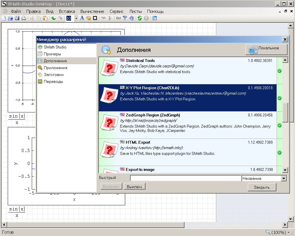

I had no problem installing the recent plugins from Online Galery made by uni and w3b5urf3r , provided all the previous user plugins deleted from the installation folder. However, there are now two folders where the plugins resides with the SMath Desktop (I think) - Installation folder ..\SMath\plugins - users folder *WIn7* ..\AppData\Roaming\SMath\extensions\plugins . I am not sure what is happening with the "SMath plugins" (made by Martin) and how that can be "portable". By the way, I mentioned this on Ubuntu that the recent build does not work. Closing the Extension manager will close SMath. I do not know if this has anything with the behavior Martin mentioned.
Not quite sure yet how is all of this going to work. Manual copying or of plugins may cause the problems. In the recent nightbuld it is said that the external plugins must be deleted and used only via Extension manager. I managed once to crash SMath by copying a plugin into the installation folder, but some other plugins cause no problems by manual copying into the plugins folder (both of them).
I think this needs to be clarified a bit.

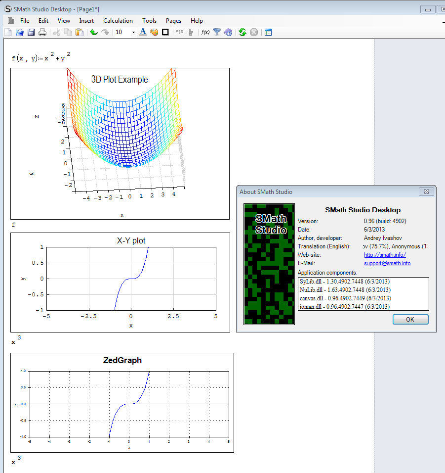

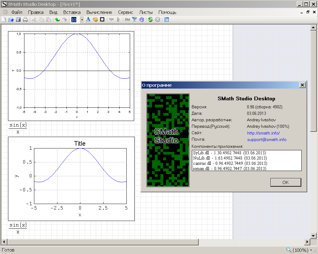

You can't use the old plug-ins with the regions. Therefore, a simple copy of the old version will fail. Do not use this way for old such plugins. As I said, they need to be recompiled with a small addition. New plugins can be copied. Do not use the plug-ins from my ftp, they are all old. Plugin Manager is not completed yet, Andrey is working on it. In any case, if there is a problem, try to remove all user's plugins manually from ..\SMath\plugins and ..\AppData\[username]\SMath\extensions\plugins, then install them from the gallery.
As for me, everything works fine:

#4 Опубликовано: 08.06.2013 06:21:40
For me as well
There is still already mentioned problem of saving graphs and the graphs settings. Am I right about it?
