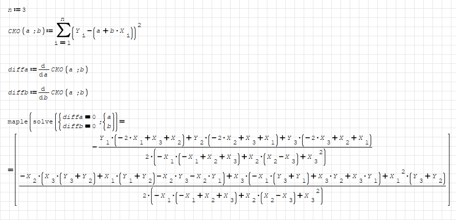

How to solve this symbolical
How to solve this symbolical - Maple in SMath - Messages
#1 Posted: 2023/7/8 12:36:53

#2 Posted: 2023/7/8 13:01:36
598 likes in 1,380 posts.
Derivatives mostly doesn't get along with solvers.
And you really need an n value to make this work.

#3 Posted: 2023/7/8 13:10:17
Valery Ochkov
Valery Ochkov
66 likes in 690 posts.
Thanks.
But I was waiting as in Mathcad

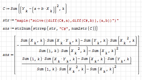

#4 Posted: 2023/7/9 01:42:37
1,123 likes in 1,795 posts.
Hi. This is a way.
linregress.sm (17.05 KiB) downloaded 1162 time(s).
linregress.pdf (85.29 KiB) downloaded 902 time(s).

#5 Posted: 2023/7/9 03:54:15
Valery Ochkov
Valery Ochkov
Hi. This is a way.
Thanks!
But what is it?
1 C:=Sum...
2 ans:=...
#6 Posted: 2023/7/9 04:47:30
Thanks!
But what is it?
1 C:=Sum...
2 ans:=...
It's a maple component from the maple tools plugin. You must to have it at the insert menu:
