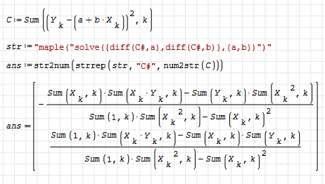

Hi. This is a way.
linregress.sm (17.05 KiB) downloaded 1358 time(s).
linregress.pdf (85.29 KiB) downloaded 1063 time(s).

Thanks!
But what is it?
1 C:=Sum...
2 ans:=...
#6 Posted: 7/9/2023 4:47:30 AM
Wrote...
Thanks!
But what is it?
1 C:=Sum...
2 ans:=...
It's a maple component from the maple tools plugin. You must to have it at the insert menu:
