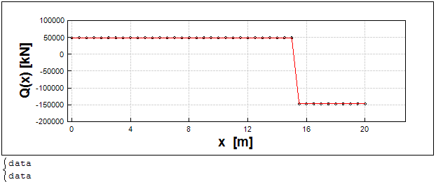

I'm new to smart studio and I'm trying to plot the graph for this function of a bi-supported beam but I can't
whyplot.sm (7.98 KiB) downloaded 1028 time(s).

You have an incorrectly written expression:
Click to enlarge

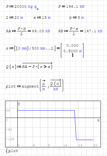

We usually plot the graph like this:
Click to enlarge
Zap units for the plot.
whyplot (else).sm (13.03 KiB) downloaded 1095 time(s).
