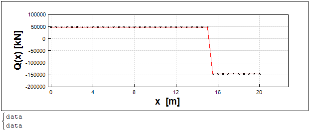

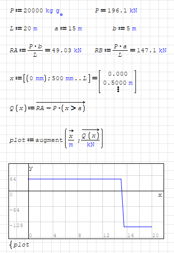

I'm new to smart studio and I'm trying to plot the graph for this function of a bi-supported beam but I can't

Something like that. The X-Y Plot plugin doesn't have advanced capabilities for working with units.
Unlike Mathcad, we have only one field for describing the graph. For this reason, we can only learn about the X variable from this description. For this, it must be undefined. The component looks for undefined variables in the expression and uses them to determine how to plot a graph. If you define the variable x, then the component will not understand how to plot the graph. The tilde sign (~) helps him with this as an analogue of the range variable in Mathcad.
whyplot (uni).sm (9,75 КиБ) скачан 1213 раз(а).
Click to enlarge
You have an incorrectly written expression:
Click to enlarge
We usually plot the graph like this:
Click to enlarge
Links:
1. X-Y Plot. Support for parametric plot type.
Zap units for the plot.
whyplot (else).sm (13,03 КиБ) скачан 1258 раз(а).
