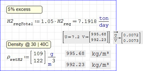

I have a figure that is mass flowrate & I have a matrix with x2 volumetric densities. I want to divide former with the latter to get x2 different volumetric flowrate. How should I proceed given I cannot simply put Matrix in divisor
Screenshot
https://prnt.sc/JVkxiL50fw46
#2 Posted: 2022/4/9 11:46:37
127 likes in 342 posts.
Use the "vectorize" function (you also find it in the right panel)

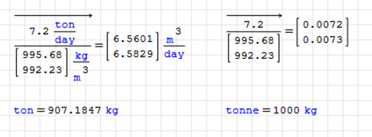

Thanks for the replies everyone...
Yes Ton / Tonne difference is important & I have corrected it in my calcs
