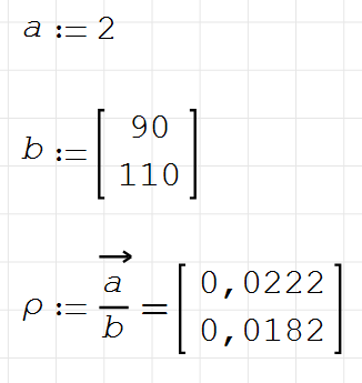

I have a figure that is mass flowrate & I have a matrix with x2 volumetric densities. I want to divide former with the latter to get x2 different volumetric flowrate. How should I proceed given I cannot simply put Matrix in divisor
Screenshot
https://prnt.sc/JVkxiL50fw46
#2 Опубликовано: 09.04.2022 11:46:37
Use the "vectorize" function (you also find it in the right panel)

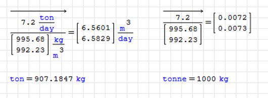

Please be very careful with this type of calculations with false units without any sense, as they can lead to fatal accidents.
#5 Опубликовано: 10.04.2022 10:23:50
Splendid remark ! because no project description.
As given T/day, add g/m³ of H2 at two different °C
#6 Опубликовано: 10.04.2022 10:31:05
Very nice and considerable advice.
Some so-called expert engineers can't even use units.
Expecting them to use correct and proper one is futile effort.
#7 Опубликовано: 12.04.2022 07:55:16
usamakhan
usamakhan
3 сообщений из 81 понравились пользователям.
Thanks for the replies everyone...
Yes Ton / Tonne difference is important & I have corrected it in my calcs
