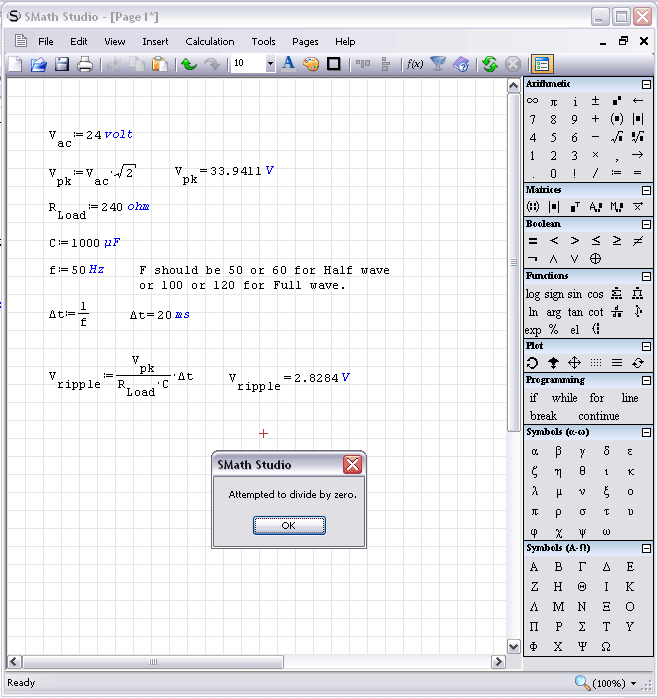

When I try to save a simple page it crashes SMath with a "Attempted to divide by zero." error. I got this error with the portable and installed version. The page works great until I try to save. I have attached a screen shot.
Thanks,
Kyle

this is my version of your sheet, please tell us if you can run and save it.
Thanks for the sample file. It does not open correctly for me. When I double click your file, I get what you see in the attached screen shot.
Thanks,
Kyle
EDIT: I get the same problem below from your file in both installed and portable version.

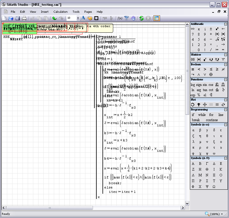

#20 Posted: 2013/3/28 12:11:57
kda406
kda406
0 likes in 20 posts.
I've noticed that if you delete some dlls, a reconfiguration window is brought up by SMath and the files are restored, I assume they are extracted from the program's exe. As a last resort, apart from upgrading .Net20, you may want to replace some files from your installation with these of mine:
Your plugins directory had tons of files which mine did not have. I extracted your and told Winzip to overwrite mine. Then I noticed you included some .sm files in the plugins directory. I opened the larger one in SMath, which you can see in the attached.
