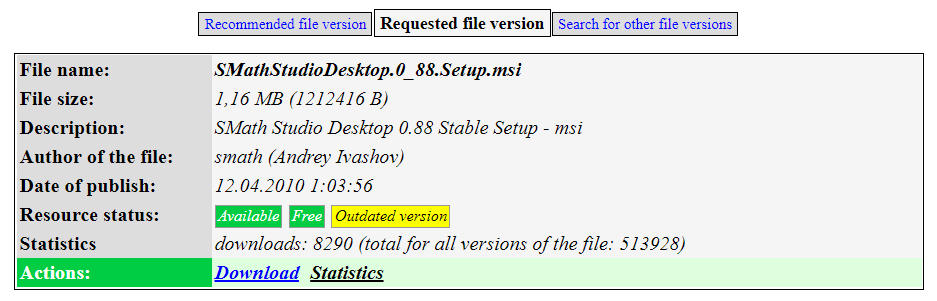

It is by design. When one tries to download old version of SMath Studio web-site will find the best version for you automatically! But please look at the download page a bit more accurate:
Do you see "Recommended file version" and "Requested file version" tabs there? Here is what one will see when presses on "Requested file version" tab:
This is solution I have decided to implement. I hope you understand why it is done so... links to the old SMath Studio packages are everywhere in the Internet and I do not want new users to download old versions of the SMath Studio as we do not have enough time to support different versions of the program. It is much cheaper just to make everything possible to deliver latest versions of the software world wide.
Best regards, Andrey Ivashov.
