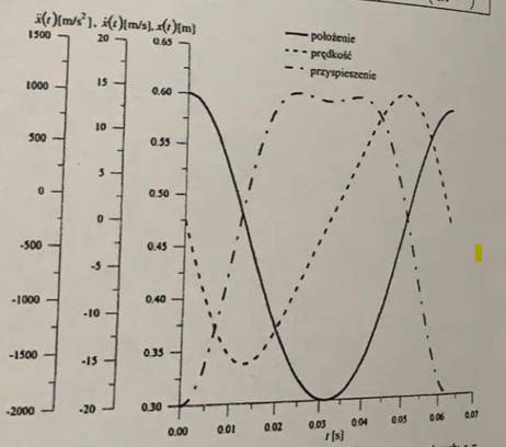

Is it possible to make such a chart with three Y axes on a single chart?
something like this
https://ibb.co/JcRn2B9
You can have as many as you want of fake style like the image.
Create Y's as image and slide close to the plot.
You can do lot more Professional ... associate each graph with Nodes Labels.
Cheers ... Jean.

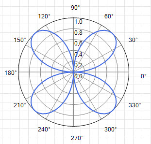

Using X-Y Plot Region, you can simulate your graph with any number of axes, but needs some programming like in this example.
XYPlot. Linear polar.sm (61.18 KiB) downloaded 1087 time(s).

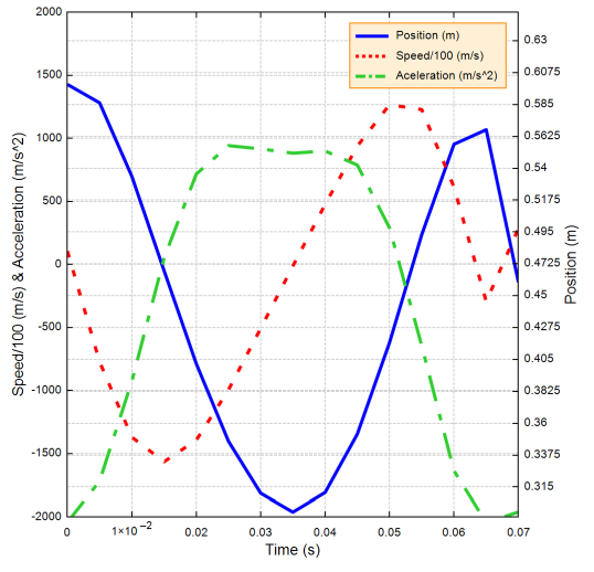

It is possible to use a graph with 2 Y-axes as shown in the image.
Carlos

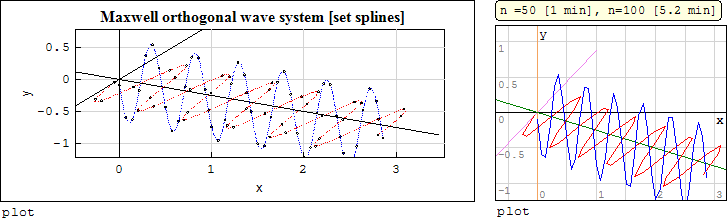

#9 Posted: 2022/5/8 17:37:38
... as many as you want horizontal/vertical,
disposed inner wrt the Quick Plot
otherwise outside X_Y past build-in default 2.
Utilities XY Label Graph MORE.sm (35.86 KiB) downloaded 1111 time(s).
