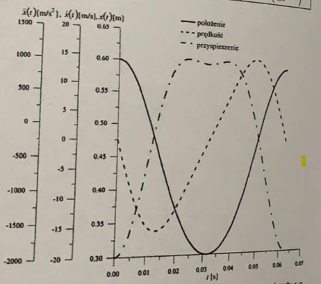

Is it possible to make such a chart with three Y axes on a single chart?
something like this
https://ibb.co/JcRn2B9

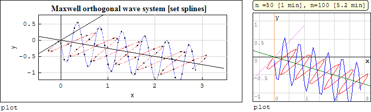

#4 Опубликовано: 06.05.2022 10:41:27
You can have as many as you want of fake style like the image.
Create Y's as image and slide close to the plot.
You can do lot more Professional ... associate each graph with Nodes Labels.
Cheers ... Jean.

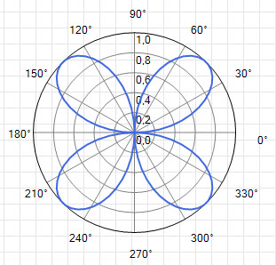

Using X-Y Plot Region, you can simulate your graph with any number of axes, but needs some programming like in this example.
XYPlot. Linear polar.sm (61,18 КиБ) скачан 1216 раз(а).

#7 Опубликовано: 06.05.2022 12:19:50
... omitted details:
1. X_Y does not accept Nodes Labels.
2. X_Y splines nicely data set, QuickPlot NOT
3. Both X_Y, QuickPlot accept 3D isometric axes.

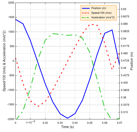

CBG
CBG
It is possible to use a graph with 2 Y-axes as shown in the image.
Carlos
#9 Опубликовано: 08.05.2022 17:37:38
... as many as you want horizontal/vertical,
disposed inner wrt the Quick Plot
otherwise outside X_Y past build-in default 2.
Utilities XY Label Graph MORE.sm (35,86 КиБ) скачан 1248 раз(а).
