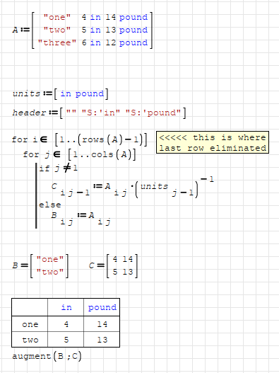

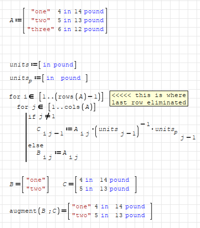

#2 Posted: 2022/9/21 19:21:22
598 likes in 1,380 posts.
How can I remove a row or column from a matrix while keeping all assigned units to the elements in the matrix.
Well you can't show it with conventional ways if it contains string column.
I am not sure if it is possible when a string column is absent if it has mixed units.
However, you can use a table region to show your new matrix.
Not an ideal solution, but it is what we can have.

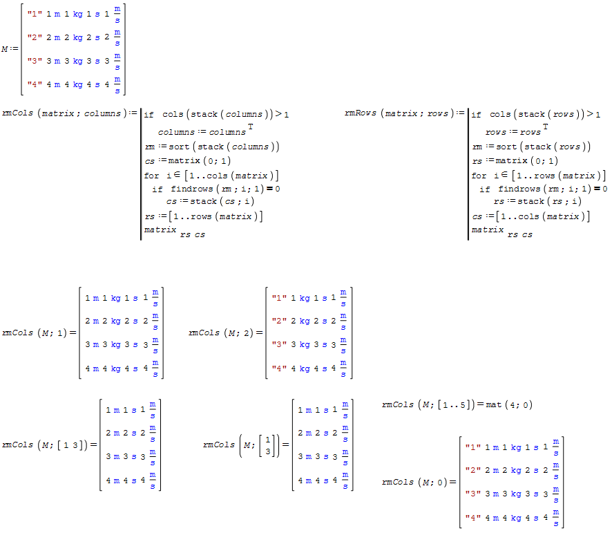

Something like this?
rmRows_rmCols.sm (35.17 KiB) downloaded 1169 time(s).

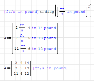

#5 Posted: 2022/9/22 19:14:03
I believe that rfreund wanted to keep the units of measurement set. I take Davide's solution and I add a trick (I think he had been offered by Overlord or Razonar or perhaps from both).
However, I still have to solve for the strings. Furthermore, if we cancel the columns instead of the lines we should build the units of measurement of the matrix resulting with the same method.
I first see usage of diag() for units by Razonar, then just wrote it as in your example.
Another way is using pseudo units, but this is also not interchangeable.
Again, these are not conventional ways. Just holding your left ear with your right hand.
And there is no solution for string column I guess.
matrix mixed units.sm (9 KiB) downloaded 1085 time(s).

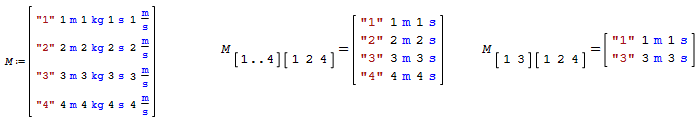

#6 Posted: 2022/9/23 04:26:49
1,355 likes in 2,271 posts.
One might use vector-valued indices.
rmRows_rmCols_Kr.sm (7.87 KiB) downloaded 1125 time(s).

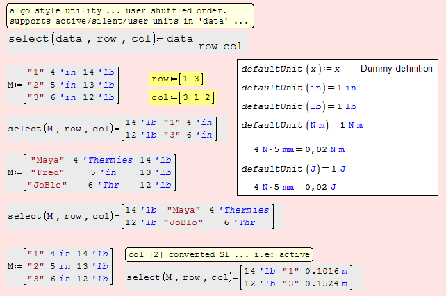

#15 Posted: 2022/11/16 08:51:17
Yes, you can remove the row or column, but no you cannot get it to display in non-SI units.
Smath is delivered with silent units or active SI ...
... silent units as required
Page4 Delete Col-Row.sm (15.27 KiB) downloaded 1211 time(s).

#18 Posted: 2022/11/17 11:38:10
Jean - it took me a minute to understand "silent-units" as I thought the apostrophe in front of the unit solved the unit "display" issue. I guess it does if you only want it to "look correct". Thanks for your efforts.
Silent mode disables the SI unit sub-processor.
Don't miss visiting this great matrix shuffling utility.
Cheers ... Jean.
Utilities Matrix Shuffle.sm (12.31 KiB) downloaded 1095 time(s).
