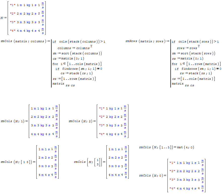

#2 Опубликовано: 21.09.2022 19:21:22
How can I remove a row or column from a matrix while keeping all assigned units to the elements in the matrix.
Well you can't show it with conventional ways if it contains string column.
I am not sure if it is possible when a string column is absent if it has mixed units.
However, you can use a table region to show your new matrix.
Not an ideal solution, but it is what we can have.

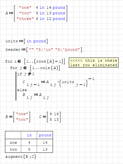

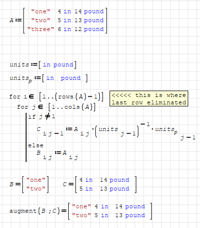

#4 Опубликовано: 22.09.2022 11:16:00
I believe that rfreund wanted to keep the units of measurement set. I take Davide's solution and I add a trick (I think he had been offered by Overlord or Razonar or perhaps from both).
However, I still have to solve for the strings. Furthermore, if we cancel the columns instead of the lines we should build the units of measurement of the matrix resulting with the same method.

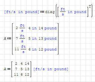

#5 Опубликовано: 22.09.2022 19:14:03
I first see usage of diag() for units by Razonar, then just wrote it as in your example.
Another way is using pseudo units, but this is also not interchangeable.
Again, these are not conventional ways. Just holding your left ear with your right hand.
And there is no solution for string column I guess.
matrix mixed units.sm (9 КиБ) скачан 1279 раз(а).

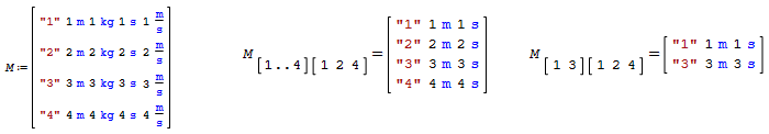

#6 Опубликовано: 23.09.2022 04:26:49
One might use vector-valued indices.
rmRows_rmCols_Kr.sm (7,87 КиБ) скачан 1300 раз(а).

#17 Опубликовано: 17.11.2022 08:20:36
Martin - I didn't realize that you could use "vector-valued indices" to reorganize matrices. That might be useful to me in the future. Although I suppose using the submatrix function is pretty similar.
The index vector approach is more flexible, as it allows to pick arbitrary subsets of rows and columns instead of continuous ranges.
iv.sm (4,1 КиБ) скачан 1281 раз(а).

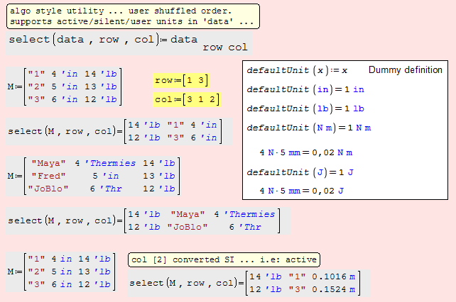

#18 Опубликовано: 17.11.2022 11:38:10
Jean - it took me a minute to understand "silent-units" as I thought the apostrophe in front of the unit solved the unit "display" issue. I guess it does if you only want it to "look correct". Thanks for your efforts.
Silent mode disables the SI unit sub-processor.
Don't miss visiting this great matrix shuffling utility.
Cheers ... Jean.
Utilities Matrix Shuffle.sm (12,31 КиБ) скачан 1288 раз(а).
