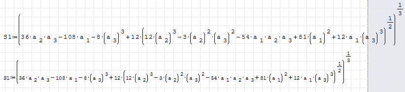

#4 Posted: 2016/3/18 22:17:13
I would imagine Andrey could implement some sort of a wrap setting.
It is all text after all.
On the other hand, if your equation does not fit in a page, are we trying to do too much
in one equation? I did run into this issue myself and I ended up separating things
Easy in Mathcad, but might turn a blody mess.
Much easier to split in components in Smath and
lot more elegant.

You shrank the font. This was not always easy in SMath (newer feature) and some old codgers yell and scream when the font sizes change in reports . As you said about Mathcad ...

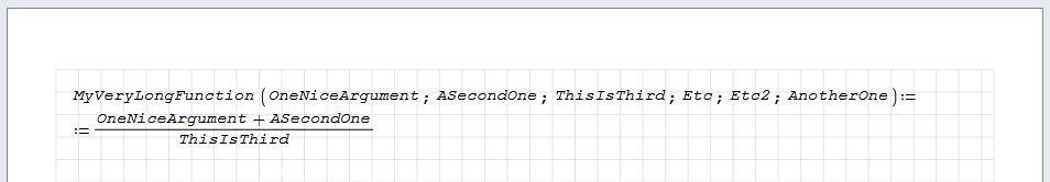

sometimes the definition of a function requires multiple arguments and if you want them to be "self-explaining" (at least to a certain level) you have to use meaningful names for those. All these conditions might bring to a long line before you can type ":" and start with a definition line.
At this point, the space on the paper for statements along the function definition might become a bit tight and the definition itself might be not printable(anything falling out of paper limit will be cutout in printing).
Any chance to have a split at ":=" in order to have the function definition beginning at the left margin of paper?
Something like:
MyVeryLongFunction(OneNiceArgument, ASecondOne, ThisIsThird, Etc, Etc2, AnotherOne):=
|A:= OneNiceArgument + Etc2
|B:= ThisIsThird * AnotherOne
|Calculation:= .....
|ToBeContinued...
Thanks for any help on this subject
Something like:
|Calculation:= .....
|ToBeContinued...
Yes, it is possible. After you have finished composing formula for definition just put the cursor before := and press Ctrl+Enter. This will produce something like
