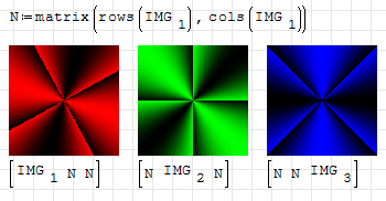

Plugin updated with [[R] [G] [B] [A]] functionality. Use SMath 0.98 +.
Given the thematic of the example, Happy Birthday!!! (to whoever this would apply).
Test and report!
ImageTestFile.pt.2.sm (3.33 MiB) downloaded 1491 time(s).

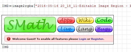

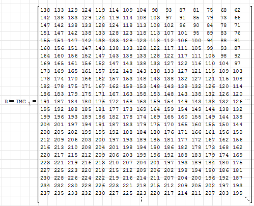

Using latest Nightly Build of SMath Studio and the last beta of Custom Functions.
Alex, can you make the double-click feature enabled just on the canvas of the region? It is really annoying while trying to edit the math content
