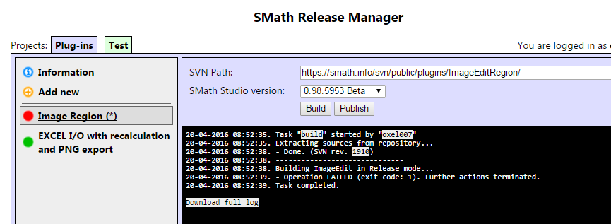

In the release manager I get an error, here is the log for the updated .csproj file in SVN
report.log.txt (45.04 KiB) downloaded 1011 time(s).

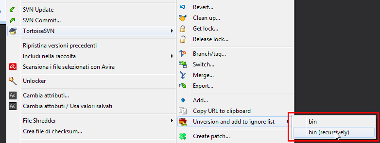

I've updated the ImageEditRegion folder in the SVN:
- removed bin and obj folders (you can add these windows folders to the ignore list, so you can avoid to commit them unintentionally);
Show Spoiler

Davide, the tweaks you made still do not allow me to build the plugin using
http://smath.info/ReleaseManager/
(same errors as in previous log)
Are you saying it works for you? Is it something to contact Andrey about?
Of course I can switch back to using old .dll's but it is not the right way going forward... Also how do I use Entry instead of Term? Will it make working with RGBA matrix faster?
Thanks

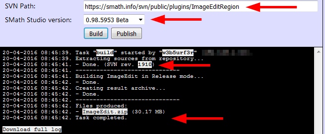

#57 Posted: 2016/4/20 12:49:06
1,443 likes in 2,935 posts.
I confirm it works for me... which is the target version you are using?
#58 Posted: 2016/4/20 12:56:00
Alexander O. Melnik
Alexander O. Melnik
127 likes in 498 posts.
Fails for me
report.log.txt (38.5 KiB) downloaded 1199 time(s).
Time to contact Andrey.
Also what is you comment on this?
Quote
Thanks!
#59 Posted: 2016/4/20 13:08:25
Fails for me
I think you are right...
warning MSB3245: Could not resolve this reference. Could not locate the assembly "SMath.Controls". Check to make sure the assembly exists on disk. If this reference is required by your code, you may get compilation errors. [{SourcesDir}\ImageEdit.csproj]
Since I don't know how it works the RM, I can only suppose that there is some sort of "cache effect" for your account because previously you have compiled the plugin with the old APIs (?)...
It may worth the effort, since images are made of a lot of data (you have to change just one thing - but actually I have no idea how to convert base.Terms to an Entry); just to mention, if you use it, the updates for SS versions < 0.98 are a little bit more difficult to provide (since you have to change the code).
#60 Posted: 2016/4/20 18:12:42
2,340 likes in 4,041 posts.
Error discovered in Release Manager. It is fixed now.
Please try to build plug-in again.
