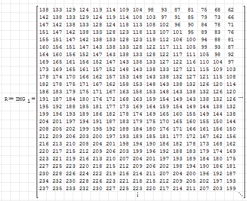

I want to remind you that we already have a function READRGB() which uses Mathcad style.
Smath opens RGB in the same style as Mathcad
This is MathcadFileAccess plugin opens.
Viacheslav,
Given that rendering capabilities of the image region were expanded, could you take a look at the READRGB() function and similar?
Currently it takes 6 times longer to read the image from file than to render it.. Is there an opportunity for a little performance bump? Maybe using the newly baked Entry[] variable could help...

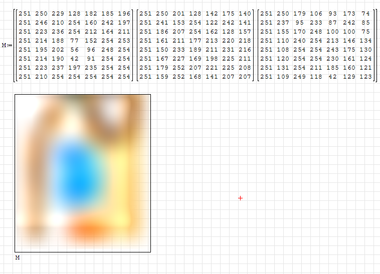

Alex, can you see this matrix in the image region?
mat(mat(251,250,229,128,182,185,196,251,246,210,254,160,242,197,251,223,236,254,212,164,211,251,214,188,77,152,254,253,251,195,202,56,96,248,254,251,214,190,42,91,254,254,251,223,237,197,235,254,254,251,210,254,254,254,254,254,8,7),mat(251,250,201,128,142,175,140,251,241,153,254,122,242,141,251,186,207,254,162,128,157,251,161,211,177,213,220,218,251,150,233,189,211,231,216,251,167,227,169,198,225,211,251,179,252,207,221,225,208,251,159,252,168,141,207,207,8,7),mat(251,250,179,106,93,173,74,251,237,95,233,87,242,85,251,155,170,248,100,100,75,251,110,240,254,213,146,134,251,108,254,254,243,175,130,251,120,254,254,230,161,124,251,131,254,211,185,160,121,251,109,249,118,42,129,123,8,7),1,3)
#72 Опубликовано: 16.05.2016 14:58:59
Alexander O. Melnik
Alexander O. Melnik
Hope its not one of those hard to trace bugs that are hardware / OS dependent
M.render.sm (8,55 КиБ) скачан 1466 раз(а).
#73 Опубликовано: 16.05.2016 15:29:20
Thank you! Solved, seems I was having a newer version installed (?)
Uninstalled and downloaded again, now it works :d

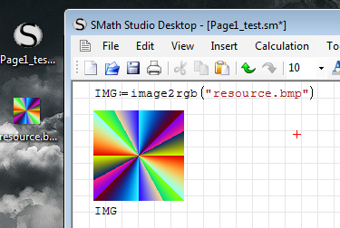

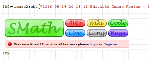

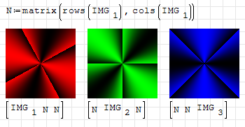

Using latest Nightly Build of SMath Studio and the last beta of Custom Functions.
Alex, can you make the double-click feature enabled just on the canvas of the region? It is really annoying while trying to edit the math content
