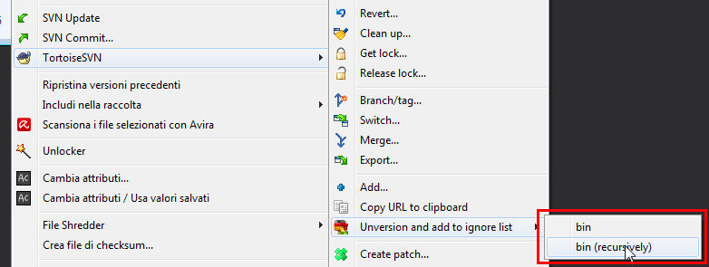

I've updated the ImageEditRegion folder in the SVN:
- removed bin and obj folders (you can add these windows folders to the ignore list, so you can avoid to commit them unintentionally);

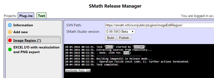

#56 Posted: 4/20/2016 12:40:52 PM
Alexander O. Melnik
Alexander O. Melnik
127 likes in 498 posts.
Davide, the tweaks you made still do not allow me to build the plugin using
http://smath.info/ReleaseManager/
(same errors as in previous log)
Are you saying it works for you? Is it something to contact Andrey about?
Of course I can switch back to using old .dll's but it is not the right way going forward... Also how do I use Entry instead of Term? Will it make working with RGBA matrix faster?
Thanks

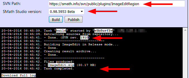

#57 Posted: 4/20/2016 12:49:06 PM
1,443 likes in 2,936 posts.
I confirm it works for me... which is the target version you are using?

Fails for me
report.log.txt (38.5 KiB) downloaded 1439 time(s).
Time to contact Andrey.

#59 Posted: 4/20/2016 1:08:25 PM
Fails for me
I think you are right...
warning MSB3245: Could not resolve this reference. Could not locate the assembly "SMath.Controls". Check to make sure the assembly exists on disk. If this reference is required by your code, you may get compilation errors. [{SourcesDir}\ImageEdit.csproj]
Since I don't know how it works the RM, I can only suppose that there is some sort of "cache effect" for your account because previously you have compiled the plugin with the old APIs (?)...

#60 Posted: 4/20/2016 6:12:42 PM
2,343 likes in 4,056 posts.
Error discovered in Release Manager. It is fixed now.
Please try to build plug-in again.
Best regards!
