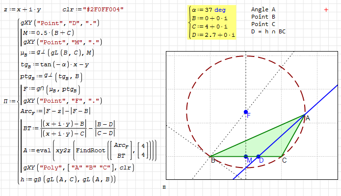

Trying to construct a triangle from an angle A, its bisector line h and the opposite side.

Hi. Something like this?
https://smath.com/en-US/cloud/worksheet/y2bVFCnr
EDIT: Uploading the files:
geom-scb.sm (70.73 KiB) downloaded 1541 time(s).
geom-scb.pdf (174.03 KiB) downloaded 882 time(s).

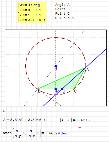

I do not quite understand your reply on my problem (:triangle from angle A, its bisector h and its opposite side a). My intention was, that the value of h is given, but as far as I can see, you are using the intersection between a and h named D instead with a coordinate for D = 2.7+0*i. I can nowhere find a value for h, and likewise I do not see a calculation of the coordinate for D, so it seems to me, that it is the coordinates for D which you are taking for given in your solution.
Please correct me if I am wrong.
In the past few weeks I have succeded in solving the problem myself, so with this reply I am just hoping, that you will comment on the above mentioned problems.

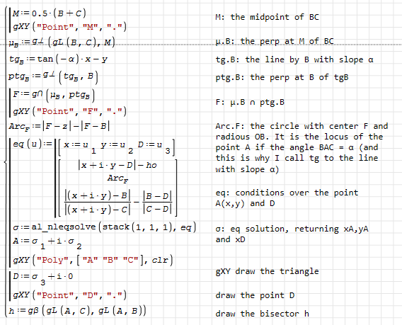

Hi. You're right, I don't show the final results, here they are:
I chose the intersection between h and BC because as given data because I don't know in which form you have the bisector: as length? as slope? The equation of the line h?

Answering your question, I define h (AD) as length.
If I use your numbers for angle A (37 degs), side BC (4) and the AD (3.6245) you have calculated from your chosen position of point D, I arrive at the same triangle as you do.

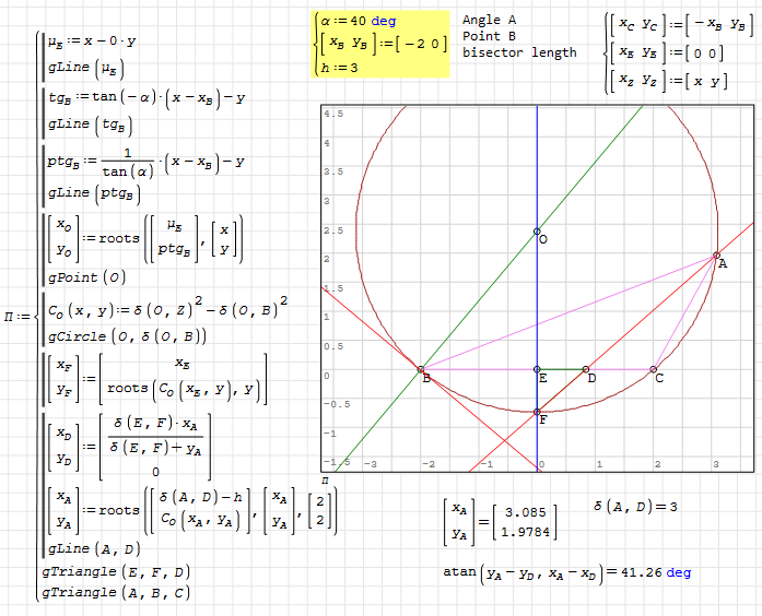

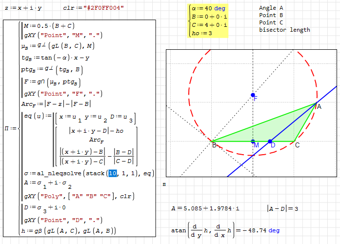

But, since I do not understand your approach, I wonder if I could challenge you to solve the following triangle (and referring to your drawing): angle A (BAC) 40 degrees, opposite side a (BC) 4 cm and angle A's bisector h (AD) 3 cm.
I'm looking forward to see your solution.

Hi Søren. This is a way for solve given the bisector length, depending of the guess value 1 or 10:
The red circle is the "arco capaz", in Spanish, I don't know how to call it in English (https://es.wikipedia.org/wiki/Arco_capaz)
Here an explanation about how to draw it by hand:
geom-scb-v2.sm (84.81 KiB) downloaded 1520 time(s).

Hi, Alvaro.
Thanks for your reply, but unfortunately I still find it difficult to comprehend your math, which of course is my problem.
Hoping, that you (and mayby some others too) would be interested in my solution, I present it here.
Yours Søren

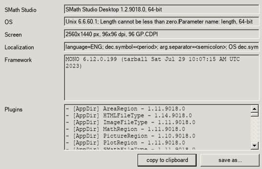

Desktop: Distro: MX-23.4_x64 Libretto January 21 2024 base: Debian GNU/Linux 12 (bookworm)
Kernel: 6.1.0-27-amd64 arch: x86_64 bits: 64 compiler: gcc v: 12.2.0
SMathStudioDesktop.1_0_8253.Mono
HP Elitebook 840 G8.
mono --version:
Mono JIT compiler version 6.8.0.105 (Debian 6.8.0.105+dfsg-3.3 Wed Dec 14 11:18:08 UTC 2022)
Copyright (C) 2002-2014 Novell, Inc, Xamarin Inc and Contributors. www.mono-project.com
TLS: __thread
SIGSEGV: altstack
Notifications: epoll
Architecture: amd64
Disabled: none
Misc: softdebug
Interpreter: yes
LLVM: supported, not enabled.
Suspend: hybrid
GC: sgen (concurrent by default)
The latest mono SmathDesktop installs, but at once I get the message. "Unhandled exception has occurred in you application". It says:" \n\nA null reference or invalid value was found[GDI+ status:InvalidParameter)." and I am urged to quit, which I do!
The AppImage for Ubuntu don't run at all.
But this is not a problem, I am living happily with the 8253 version.

As I have suspected, you are using Debian.
Debian or is derivatives has a Mono problem.
Not only Debian; Ubuntu, Mint, etc has this issue too.
And not limited to Smath, I encountered this for other programs also.
Their glibc and mono binaries giving some problems.
Fortunately, it has a solution.
You have to edit smathstudio_desktop_mono.
Just put export MONO_WINFORMS_XIM_STYLE=disabled command before exec.
Here is the links for discussion of solution;
https://en.smath.com/forum/yaf_postsm84311_SMath-in-Linux.aspx#post84311
https://en.smath.com/forum/yaf_postsm85676_SMath-Studio-on-Linux.aspx#post85676

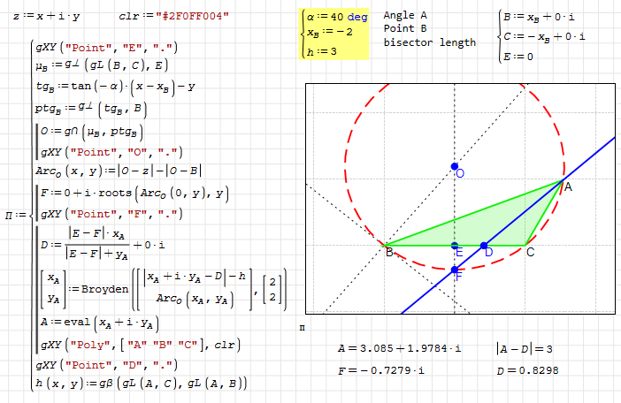

#11 Posted: 2024/11/13 01:05:44
1,123 likes in 1,795 posts.
Hi Søren. Your geometry theory is more powerful than mine. Using your theorems, notation and coordinate system, this is a simplified version:
geom-scb-v3.sm (44.67 KiB) downloaded 1498 time(s).

Hi Alvaro.
Thank you for your revised algorithm, which I eventually will be able to test if I ever get the latest version of SmathStudio to work on my Linux.
Yours Søren

To Overlord.
Your little fix did not work on my MXLinux. SmathStudio installs, but every time I try to load or save a file, SmathStudio stops and is showing the before mentioned message.
But I can easily live with the older version of SmathStudio, and I am not willing to change distribution, since I am very happy with MXLinux in every other respect.
Anyway - thank you for trying to help me out.

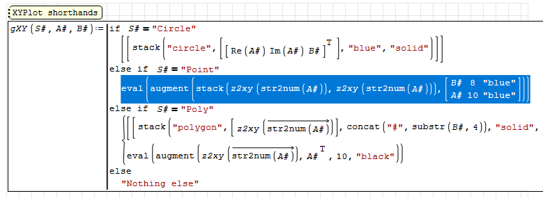

Hi Alvaro,
this is just a seek for clarification about your usage of the XY Plot because it is something new to me and it is very interesting .
To draw what is in the XY Plot module you write in Π a procedure that describe the steps needed to execute the drawing .
I was not aware that this was possible and moreover you use in Π the function gXY defined in the snippet area to execute/define some graphical primitives.
My question is where do you find info's that explain this method ? Can you add some detail on where this was documented in more detail ?
I apologize for these super newbie questions but as I stated initially is just for sake of learning something that looks to me very powerful and useful.
Thanks in advance for any help and best regards
Franco

He creatively recycle examples from the first page of the description of the X-Y Plot component, which supports a several settings of tasks for drawing.
XYPlot. Examples.sm (30.04 KiB) downloaded 3677 time(s).
This could be happening because your mono version is very old.
Latest is 6.12 I guess. but if you don't need new versions that's ok.

Ciao Franco. As Viacheslav says, I use the available elements according to their functionality. Also remember how line() works: it returns only the last value it has present, and can be used in many contexts, for example, in a table
TableWithLine.sm (6.71 KiB) downloaded 1414 time(s).

Minor code optimization. The number of primitives (Points) will be halved.
It makes sense to add a draw string for shapes.
geom-scb-v4.sm (44.28 KiB) downloaded 1540 time(s).
Hi Viacheslav. Thanks, looks good.
Plugin less version, for instance, it works in live SMath: https://smath.com/en-US/cloud/worksheet/mCZMURm2
geom-scb-real-valued.sm (28.76 KiB) downloaded 1445 time(s).
