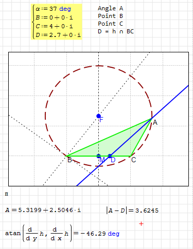

Trying to construct a triangle from an angle A, its bisector line h and the opposite side.

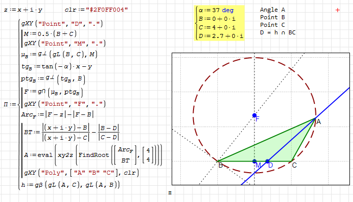

#2 Posted: 10/22/2024 2:41:52 AM
1,139 likes in 1,805 posts.
Hi. Something like this?
https://smath.com/en-US/cloud/worksheet/y2bVFCnr

I do not quite understand your reply on my problem (:triangle from angle A, its bisector h and its opposite side a). My intention was, that the value of h is given, but as far as I can see, you are using the intersection between a and h named D instead with a coordinate for D = 2.7+0*i. I can nowhere find a value for h, and likewise I do not see a calculation of the coordinate for D, so it seems to me, that it is the coordinates for D which you are taking for given in your solution.
Please correct me if I am wrong.

Hi. You're right, I don't show the final results, here they are:
I chose the intersection between h and BC because as given data because I don't know in which form you have the bisector: as length? as slope? The equation of the line h?

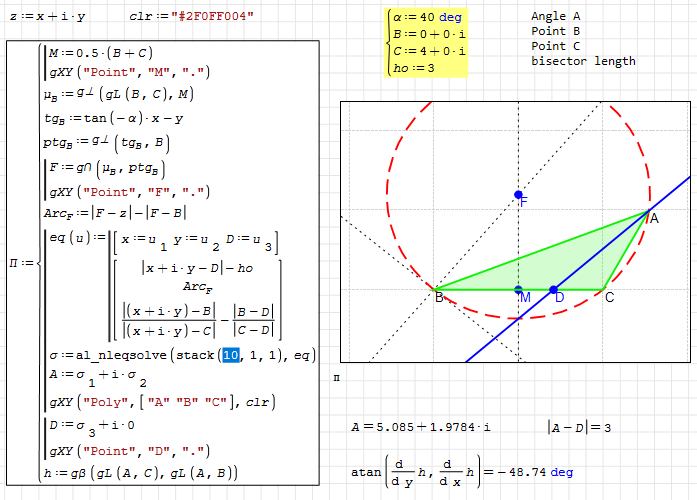

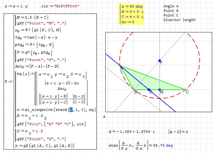

Answering your question, I define h (AD) as length.
If I use your numbers for angle A (37 degs), side BC (4) and the AD (3.6245) you have calculated from your chosen position of point D, I arrive at the same triangle as you do.
But, since I do not understand your approach, I wonder if I could challenge you to solve the following triangle (and referring to your drawing): angle A (BAC) 40 degrees, opposite side a (BC) 4 cm and angle A's bisector h (AD) 3 cm.
I'm looking forward to see your solution.

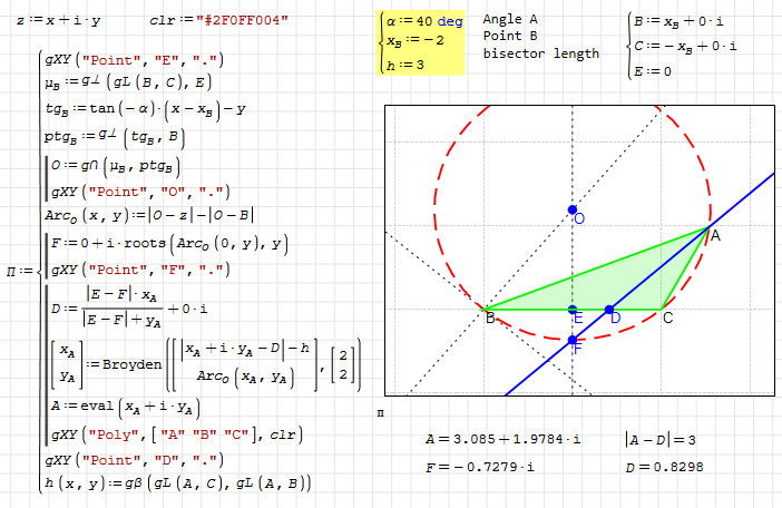

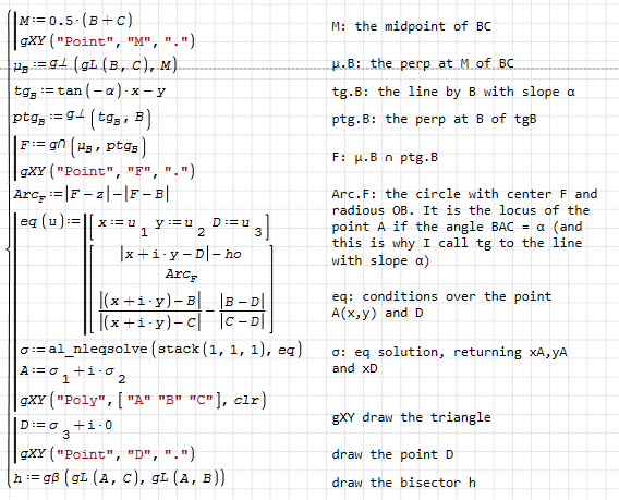

Hi Søren. This is a way for solve given the bisector length, depending of the guess value 1 or 10:
The red circle is the "arco capaz", in Spanish, I don't know how to call it in English (https://es.wikipedia.org/wiki/Arco_capaz)
Here an explanation about how to draw it by hand:
geom-scb-v2.sm (84.81 KiB) downloaded 1755 time(s).

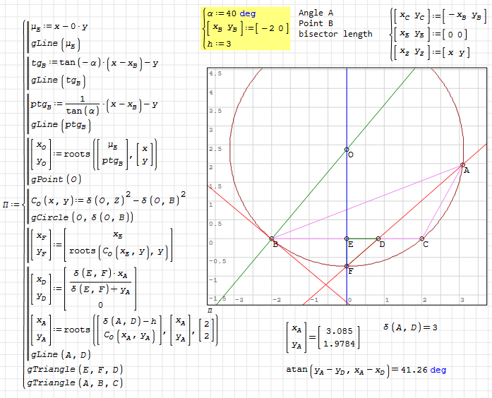

Hoping, that you (and mayby some others too) would be interested in my solution, I present it here.
Yours Søren

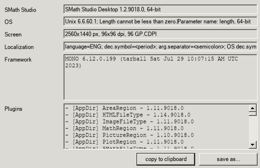

Desktop: Distro: MX-23.4_x64 Libretto January 21 2024 base: Debian GNU/Linux 12 (bookworm)
Kernel: 6.1.0-27-amd64 arch: x86_64 bits: 64 compiler: gcc v: 12.2.0
SMathStudioDesktop.1_0_8253.Mono
HP Elitebook 840 G8.
mono --version:
Mono JIT compiler version 6.8.0.105 (Debian 6.8.0.105+dfsg-3.3 Wed Dec 14 11:18:08 UTC 2022)
Copyright (C) 2002-2014 Novell, Inc, Xamarin Inc and Contributors. www.mono-project.com
TLS: __thread
SIGSEGV: altstack
Notifications: epoll
Architecture: amd64
Disabled: none
Misc: softdebug
Interpreter: yes
LLVM: supported, not enabled.
Suspend: hybrid
GC: sgen (concurrent by default)
The latest mono SmathDesktop installs, but at once I get the message. "Unhandled exception has occurred in you application". It says:" \n\nA null reference or invalid value was found[GDI+ status:InvalidParameter)." and I am urged to quit, which I do!
The AppImage for Ubuntu don't run at all.
But this is not a problem, I am living happily with the 8253 version.

As I have suspected, you are using Debian.
Debian or is derivatives has a Mono problem.
Not only Debian; Ubuntu, Mint, etc has this issue too.
And not limited to Smath, I encountered this for other programs also.
Their glibc and mono binaries giving some problems.
Fortunately, it has a solution.
You have to edit smathstudio_desktop_mono.
Just put export MONO_WINFORMS_XIM_STYLE=disabled command before exec.
Here is the links for discussion of solution;
https://en.smath.com/forum/yaf_postsm84311_SMath-in-Linux.aspx#post84311
https://en.smath.com/forum/yaf_postsm85676_SMath-Studio-on-Linux.aspx#post85676

Hi Søren. Your geometry theory is more powerful than mine. Using your theorems, notation and coordinate system, this is a simplified version:
geom-scb-v3.sm (44.67 KiB) downloaded 1729 time(s).
Вячеслав Мезенцев 11/14/2024 12:29:00 AM

Your little fix did not work on my MXLinux. SmathStudio installs, but every time I try to load or save a file, SmathStudio stops and is showing the before mentioned message.
But I can easily live with the older version of SmathStudio, and I am not willing to change distribution, since I am very happy with MXLinux in every other respect.
Anyway - thank you for trying to help me out.

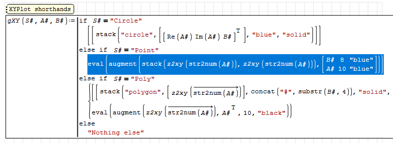

Hi Alvaro,
this is just a seek for clarification about your usage of the XY Plot because it is something new to me and it is very interesting .
To draw what is in the XY Plot module you write in Π a procedure that describe the steps needed to execute the drawing .
I was not aware that this was possible and moreover you use in Π the function gXY defined in the snippet area to execute/define some graphical primitives.
My question is where do you find info's that explain this method ? Can you add some detail on where this was documented in more detail ?

#15 Posted: 11/13/2024 7:50:59 PM
1,558 likes in 1,868 posts.
He creatively recycle examples from the first page of the description of the X-Y Plot component, which supports a several settings of tasks for drawing.
This could be happening because your mono version is very old.
Latest is 6.12 I guess. but if you don't need new versions that's ok.

Ciao Franco. As Viacheslav says, I use the available elements according to their functionality. Also remember how line() works: it returns only the last value it has present, and can be used in many contexts, for example, in a table
TableWithLine.sm (6.71 KiB) downloaded 1633 time(s).
