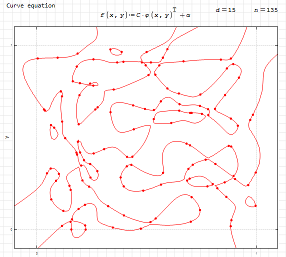

I can plot an ellipse or a hyperbola
See please Ellipse-Hyperbola.sm (11.37 KiB) downloaded 838 time(s).
But cannot plot cubic lines.
Cubica.sm (29.75 KiB) downloaded 848 time(s).
Is it my or SMath error?
See please also
https://community.ptc.com/t5/Mathcad/Cubica/m-p/496877
Thanks!
#2 Posted: 2023/10/31 06:02:05
1,078 likes in 1,749 posts.
Hi Vladimir. The problem is the poor quality of SMath's numerical code for linear algebra. A workaround is to redefine the determinant using some plugin.
Cubica.sm (31.1 KiB) downloaded 782 time(s).
Valery Ochkov 2023/10/31 07:54:00, Oscar Campo 2023/10/31 09:30:00

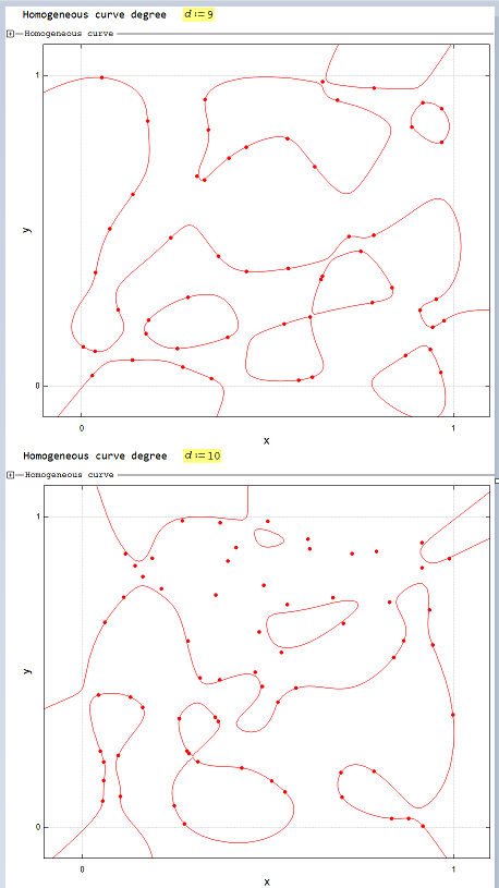

#3 Posted: 2023/10/31 09:58:55
General case.
Homogeneous Curve.sm (27.07 KiB) downloaded 832 time(s).
Valery Ochkov 2023/10/31 12:43:00, Oscar Campo 2023/10/31 16:54:00

Yes, that's the sequence. It is the number of coefficients that have a homogenous bilinear form in two variables. And is the number of rows in the matrix 'v' in the file.
Limit at n=10
I put the comments backwards. For big n, disable the SMath matrix inverse method and use dn_LinAlgSolve.
Homogeneous Curve.sm (31.07 KiB) downloaded 776 time(s).

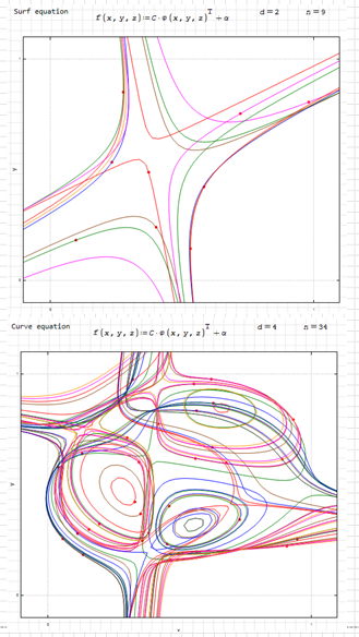

I suppose it can be easily generalized to three dimensions, except for the part of graphing the surface, since there we would not have the usefulness of XYPlot to graph implicit functions.
#9 Posted: 2023/11/1 02:54:32
With n level curves, one passes through each X,Y pair at level Z. For d=1, we have a plane, d=2 a quadric, etc.
Homogeneous Surface.sm (33.63 KiB) downloaded 833 time(s).
