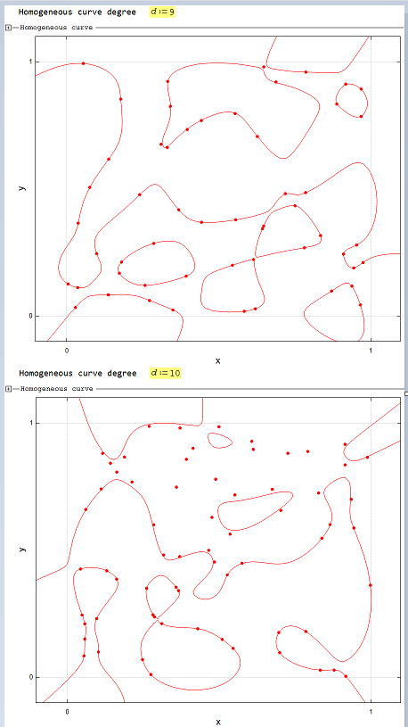

General case.
Homogeneous Curve.sm (27,07 КиБ) скачан 1466 раз(а).

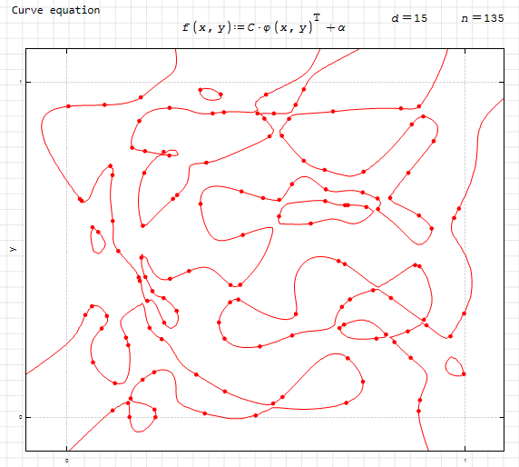

Yes, that's the sequence. It is the number of coefficients that have a homogenous bilinear form in two variables. And is the number of rows in the matrix 'v' in the file.
Limit at n=10
I put the comments backwards. For big n, disable the SMath matrix inverse method and use dn_LinAlgSolve.
Homogeneous Curve.sm (31,07 КиБ) скачан 1388 раз(а).

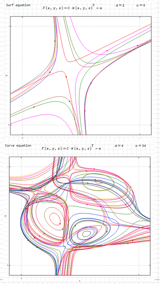

With n level curves, one passes through each X,Y pair at level Z. For d=1, we have a plane, d=2 a quadric, etc.
Homogeneous Surface.sm (33,63 КиБ) скачан 1470 раз(а).
