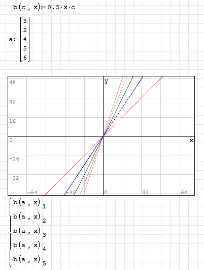

I would like to be able to automate the creation of the system of equations for a plot.
For the example attached, the function b(c,x) is used to plot, with the matrix "a" as the input. Currently with this setup, I would have to input each row of the function individually into the system of equations for a plot.
I would like to be able to increase or decrease the size of matrix "a" without having to edit the input of the plot.
Any ideas on how I could do that???
plots.sm (3.79 KiB) downloaded 638 time(s).

Try so
plots1.sm (3.95 KiB) downloaded 680 time(s).

That's great! For the application that I needed, it as a system of matrices instead of a system of equations, and for that case I used mat2sys1.
Thanks for the help, I have never used that function, so I don't think I would've come up with using it.
