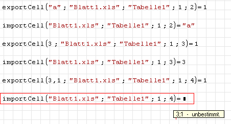

Hi martin,
you can try with the SMath matrix editor. (actually not available beacuse the wiki server is unavailable)
If you are brave enough you can try with the plugin attached here (it's a beta, I'm sure that works for the common cases but I have not had time to check for special cases)
EDIT: here there is the plugin updated and extended
regards,
w3b5urf3r

thank you for your help. Export CSV function is that what I need.
Now I can be happy user of Smath
