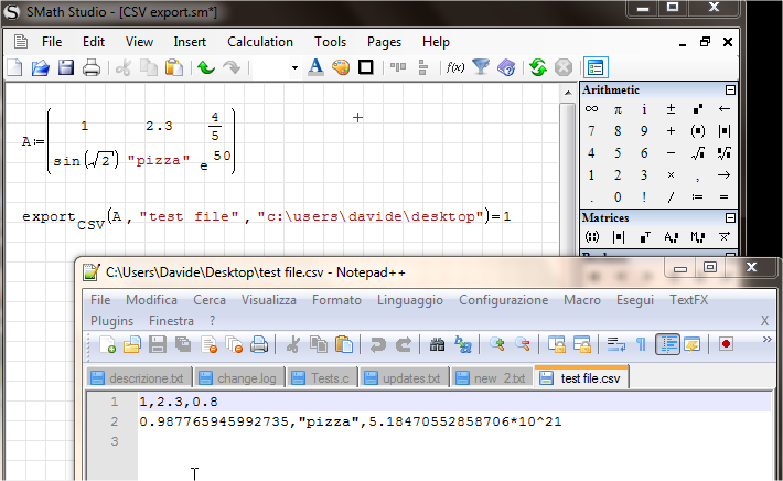

If you are brave enough you can try with the plugin attached here (it's a beta, I'm sure that works for the common cases but I have not had time to check for special cases)
EDIT: here there is the plugin updated and extended

thank you for your help. Export CSV function is that what I need.
Now I can be happy user of Smath
