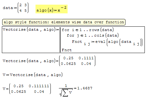

Jean,
thanks a lot for sharing ...your approach with the algo technique of passing a function ..to a function is very interesting .
It is something I had never thought that was possible to do, it is very elegant and concise.
Thanks again and best regards
Franco

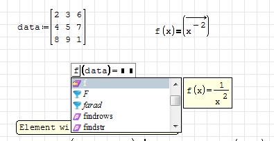

[albumimg]1430[/albumimg]
Thank you for pointing it out.
From programmers point of view everything goes correctly here. You tries to transpose every single element of matrix, which is not allowed by the program (as transpose operation can be applied for matrices and vectors only). But on other side I see it will be very handy to have transpose operation in some exceptions list for vectorization.
Will check what I can do...
Best regards, Andrey Ivashov.

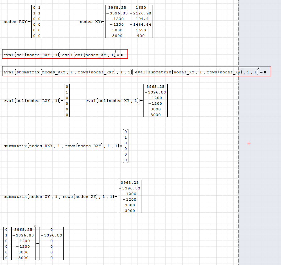

It is unfortunate that eval() prevents vectorize() from evaluating its arguments one-by-one.
For example:
f(x):=(1/x)^2
vectorize(mat(1,2,3,4,2,2))=mat(1,0.25,0.1111,0.0625,2,2)
f(x):eval((1/x)^2)
vectorize(mat(1,2,3,4,2,2))=mat(5.5,-2.5,-3.75,1.75,2,2)
If the expression of vectorize is optimized before by-element evaluation, then it's impossible to use, say, linterp() in such functions, and eval doesn't help.
С уважением, Михаил Каганский

... and you have it wrong both ways. Solution is: return Smath to the last working
version [5346], litle simples step of more maths and more conviviality... issue patch.
linterp what ? you just have the Y vector !

I have it wrong both ways? What do you mean by that? Have you read that carefully? First way I get absolutely correct matrix of original numbers raised to power (-2). How is that incorrect? Or do you think that you know my requirements better?
Your method works, and fine. I have mine, working too. But what I write about isn't call for help "Hey! I'm lost in two trees! How do I calculate them?", but a proposal to enable more powerful use of new shiny feature.
"linterp what ? you just have the Y vector !" - I wrote that if some of my function internally uses linterp for some reason, it currently automatically isn't fit for use inside vectorise.
I'm trying to replace a number of loops in my files that are used to fill matrices, with a cleaner syntax of vectorise. And I meet with some limitation that MAY be curable if Andrey decides that it's possible (and that's not too difficult taking into account his code).
Specifically, I attach a file that I tried to cleanup today. One of loops is marked by magenta. It's impossible to rephrase it like is shown to the right of it on margin (highlighted by red), though both Q and t are vectors that I want to be used one-by-one, to get resulting vector of formula results. The problem is that the functions that are used in my top-most function use *interp() on some other matrices, and that makes this syntax illegal. I dream of a proposed here "novectorize" or suchlike...
Regulirujushchijj klapan.sm (232.93 KiB) downloaded 1259 time(s).
#38 Posted: 2016/3/22 16:07:26
In the attached, your clean creation of dual vector is suggested. You could probably work a long route by creating the model of T, P data set. By inspection it looks simple polynomial fit. Seeing
ΔP make me think your are trying to compute some MassFlow in association with m^3. You may not have
the appropriate formulation ... which is in construction in my design board, maybe a day or two.
On the other hand ΔP.доЦТП:vectorize(Δp(Q,D,L,Δ.э,t)) is not a function definition.
If I'm correct assuming you try to compute MassFlow, better start working unitless to ease reading.
Regulirujushchijj klapan Notes.sm (292.54 KiB) downloaded 1339 time(s).
