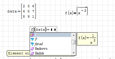

recently i found out about an issue with the Viewer, might it be possible to fix the update proces while using plugins like the comboboxList?
Please see the example pictures and you see the posibilities of the second list don't change
with the selection made in the first one, wich is non of a problem using
the file with SMath Studio... only with the Viewer it fails.
Thanks a lot for concerning!
I'd appreciate your help very much!

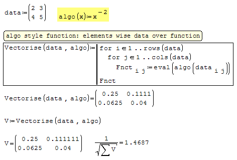

Jean,
thanks a lot for sharing ...your approach with the algo technique of passing a function ..to a function is very interesting .
It is something I had never thought that was possible to do, it is very elegant and concise.
Thanks again and best regards

First of all - thank you, Andrey, vectorize() can be EXTREMELY useful.
My vote goes for creating no exceptions. Its way easier for end user to understand why vectorize() throws an error (inverse of zero for example), rather than understanding why one "exception" works but not another.
A logically valid workaround is use of eval() inside vectorize - it just makes sense, easy to document and achieves the end goal.
If anything we could use a symbolic alternative of eval() (or does it already exist)?
Cheers All
Davide Carpi 3/9/2016 1:20:00 PM
That's an interesting and clean approach
Since eval() force evaluation in place, maybe a novectorize() [like noparse in bbcode] may be an alternative to keep the symbolic data

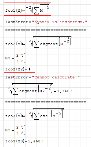

I'm not sure if this had been asked:
Currently, it's impossible to create a function like
f(M)=sum(M)
because sum takes only matrices, and M here is unknown type.
Using, say, augment(), which return type is known to be a matrix, I can do this:
f(M)=sum(augment(M))
I cannot use vectorize(), because its return type may be scalar like in vectorize(1), or system.
Though I can use it with eval().
The question is, is it possible to make vectorize always return matrix? When argument is a operation on system, for example, the result type differs from input. Having this could allow for such constructs without evals.
Or maybe allow sum to accept any type of input, making it return input itself if it's scalar/system/string?

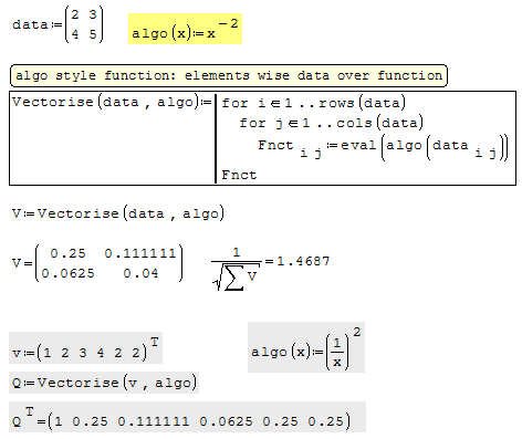

It is unfortunate that eval() prevents vectorize() from evaluating its arguments one-by-one.
For example:
f(x):=(1/x)^2
vectorize(mat(1,2,3,4,2,2))=mat(1,0.25,0.1111,0.0625,2,2)
f(x):eval((1/x)^2)
vectorize(mat(1,2,3,4,2,2))=mat(5.5,-2.5,-3.75,1.75,2,2)
If the expression of vectorize is optimized before by-element evaluation, then it's impossible to use, say, linterp() in such functions, and eval doesn't help.
С уважением, Михаил Каганский

Vectorise is specific to Mathcad, then new to Smath.
A risky new bugger that does not speak, won't match
Mathcad either ... and almost impossible to exhaust.
We can expect more and more of that in the Forum.

Though when I read things like that:
... and you have it wrong both ways. Solution is: return Smath to the last working
version [5346], litle simples step of more maths and more conviviality... issue patch.
linterp what ? you just have the Y vector !
I start to think that you want to be rude.
I have it wrong both ways? What do you mean by that? Have you read that carefully? First way I get absolutely correct matrix of original numbers raised to power (-2). How is that incorrect? Or do you think that you know my requirements better?
Your method works, and fine. I have mine, working too. But what I write about isn't call for help "Hey! I'm lost in two trees! How do I calculate them?", but a proposal to enable more powerful use of new shiny feature.
"linterp what ? you just have the Y vector !" - I wrote that if some of my function internally uses linterp for some reason, it currently automatically isn't fit for use inside vectorise.
I'm trying to replace a number of loops in my files that are used to fill matrices, with a cleaner syntax of vectorise. And I meet with some limitation that MAY be curable if Andrey decides that it's possible (and that's not too difficult taking into account his code).
Specifically, I attach a file that I tried to cleanup today. One of loops is marked by magenta. It's impossible to rephrase it like is shown to the right of it on margin (highlighted by red), though both Q and t are vectors that I want to be used one-by-one, to get resulting vector of formula results. The problem is that the functions that are used in my top-most function use *interp() on some other matrices, and that makes this syntax illegal. I dream of a proposed here "novectorize" or suchlike...
Regulirujushchijj klapan.sm (232.93 KiB) downloaded 1431 time(s).

About foo1 and foo2 you can avoid the evaluation on assignment using a programming function (line()); no ways to use vectorize on linterp
foo.sm (20.62 KiB) downloaded 1532 time(s).
Any further improvement on vectorize is welcome from my side
Mike Kaganski 3/22/2016 8:12:00 PM

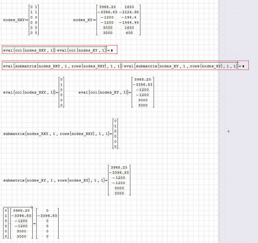

#40 Posted: 3/30/2016 12:13:03 PM
Ruben Sidranski
Ruben Sidranski
17 likes in 465 posts.
The problem is that "vectorize" is not passed through with the function definition
You will notice that the vectorization "arrow" is missing in the definition of f
