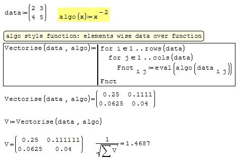

Sergio,
Your example that works elements wise, check for other issue:
vectorise as you did ... SQRT( ... result at the bottom of
the attached work sheet in light red.
Utilities Matrix Vectorise EXPRESS.sm (56,49 КиБ) скачан 1481 раз(а).
... read more as well.

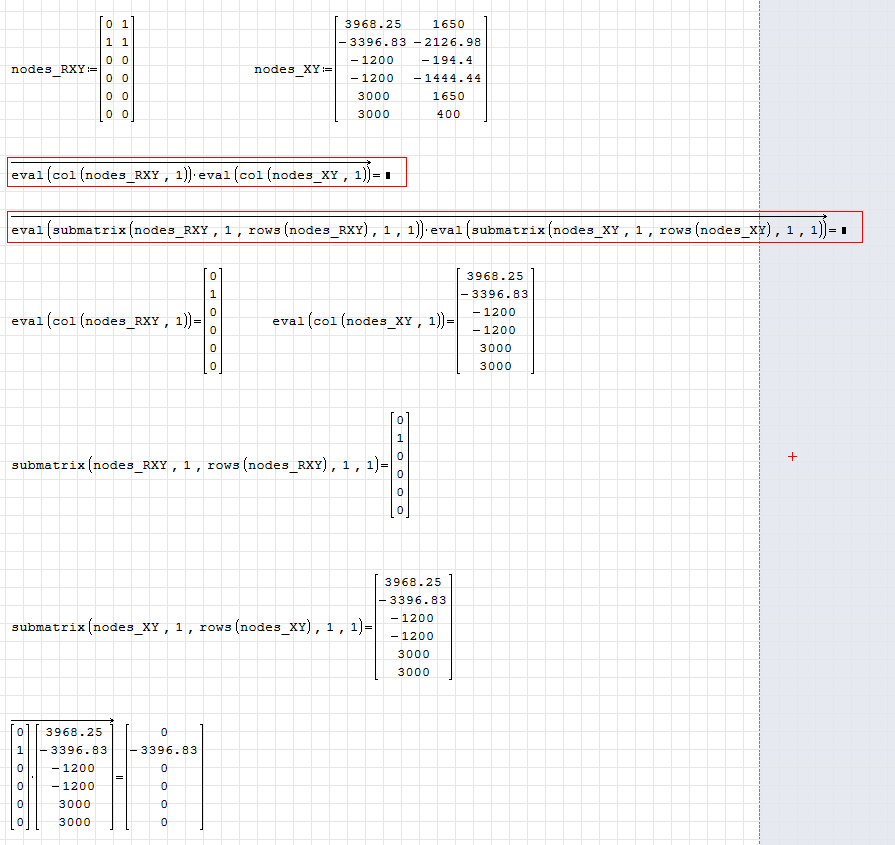

sergio 09.03.2016 06:05:00
#23 Опубликовано: 09.03.2016 03:14:21
What do you think Andrey to put then invert() function as well in the exception?
Function transpose() will get into the operator but invert() will not. Therefore, there is quite a difference between rising a matrix to a negative power inside vectorize() and having invert() inside vectorize(). For example, we have abs() and det() but inside vectorize() there is visually no difference.
I also hope this will not open some other issues regarding the vectorize() function.

#24 Опубликовано: 09.03.2016 03:35:36
Quite right Radovan,
That will require a "task force" checking wrt Mathcad.
The collection of vectorise is huge ! and would be
partial wrt functions not implemented in Smath. In the
mean time, the options in the previously attached
work sheets are VISIBLE. The risk of conflict between
"conventions" and "inventions" is silent/present.
Remember the Smath missing col operator <,> ... +++
Radovan Omorjan 09.03.2016 04:51:00

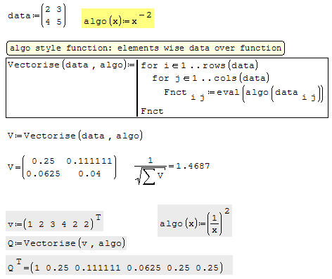

#34 Опубликовано: 22.03.2016 01:09:26
Mike Kaganski
Mike Kaganski
It is unfortunate that eval() prevents vectorize() from evaluating its arguments one-by-one.
For example:
f(x):=(1/x)^2
vectorize(mat(1,2,3,4,2,2))=mat(1,0.25,0.1111,0.0625,2,2)
f(x):eval((1/x)^2)
vectorize(mat(1,2,3,4,2,2))=mat(5.5,-2.5,-3.75,1.75,2,2)
If the expression of vectorize is optimized before by-element evaluation, then it's impossible to use, say, linterp() in such functions, and eval doesn't help.
С уважением, Михаил Каганский
#35 Опубликовано: 22.03.2016 08:55:01
Vectorise is specific to Mathcad, then new to Smath.
A risky new bugger that does not speak, won't match
Mathcad either ... and almost impossible to exhaust.
We can expect more and more of that in the Forum.

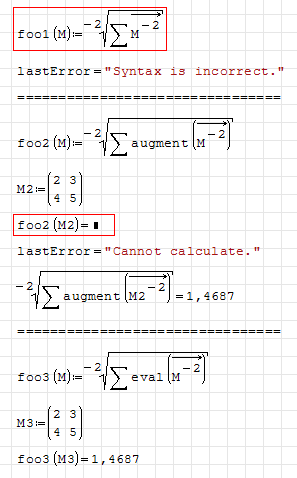

#39 Опубликовано: 22.03.2016 19:44:54
About foo1 and foo2 you can avoid the evaluation on assignment using a programming function (line()); no ways to use vectorize on linterp
foo.sm (20,62 КиБ) скачан 1528 раз(а).
Any further improvement on vectorize is welcome from my side
Mike Kaganski 22.03.2016 20:12:00

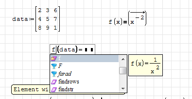

#40 Опубликовано: 30.03.2016 12:13:03
Ruben Sidranski
Ruben Sidranski
The problem is that "vectorize" is not passed through with the function definition
You will notice that the vectorization "arrow" is missing in the definition of f
