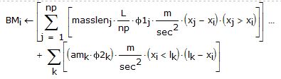

I am trying to convert a Mathcad 15 sheet, and have a problem with the below equation:
Is there a summation within Smath that will do the second summation?

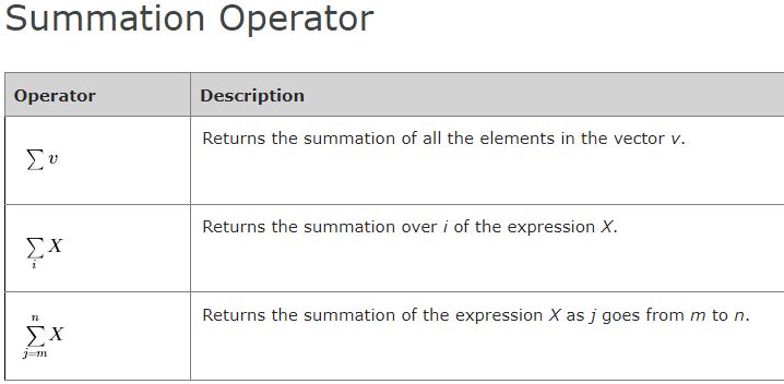

From the Mathcad help:

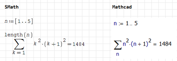

Hi. There are not equivalent, but this is how to convert it into usual summation operator.

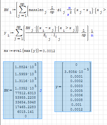

Attached is sheet, this is a MRM for beam frequency analysis

#5 Posted: 2021/12/10 08:18:09
Sum over 'n' ... NOT over 'k'
Model summation attached.
Function Running Summation.sm (32.66 KiB) downloaded 726 time(s).

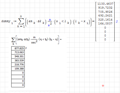

I think that there should be such a replacement.

You can use debugging in both programs to check that the functions are working correctly.
