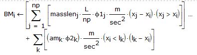

I am trying to convert a Mathcad 15 sheet, and have a problem with the below equation:
Is there a summation within Smath that will do the second summation?

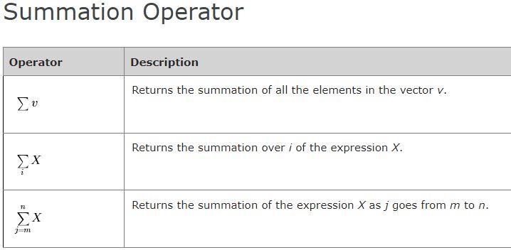

From the Mathcad help:
Thanks in advance
Ian

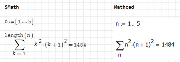

Hi. There are not equivalent, but this is how to convert it into usual summation operator.

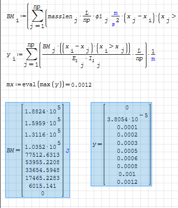

I think that there should be such a replacement.
Файл не найден. Файл не найден.

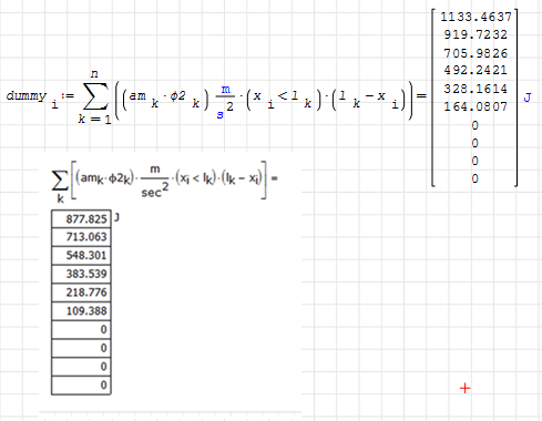

You can use debugging in both programs to check that the functions are working correctly.
Click to enlarge
