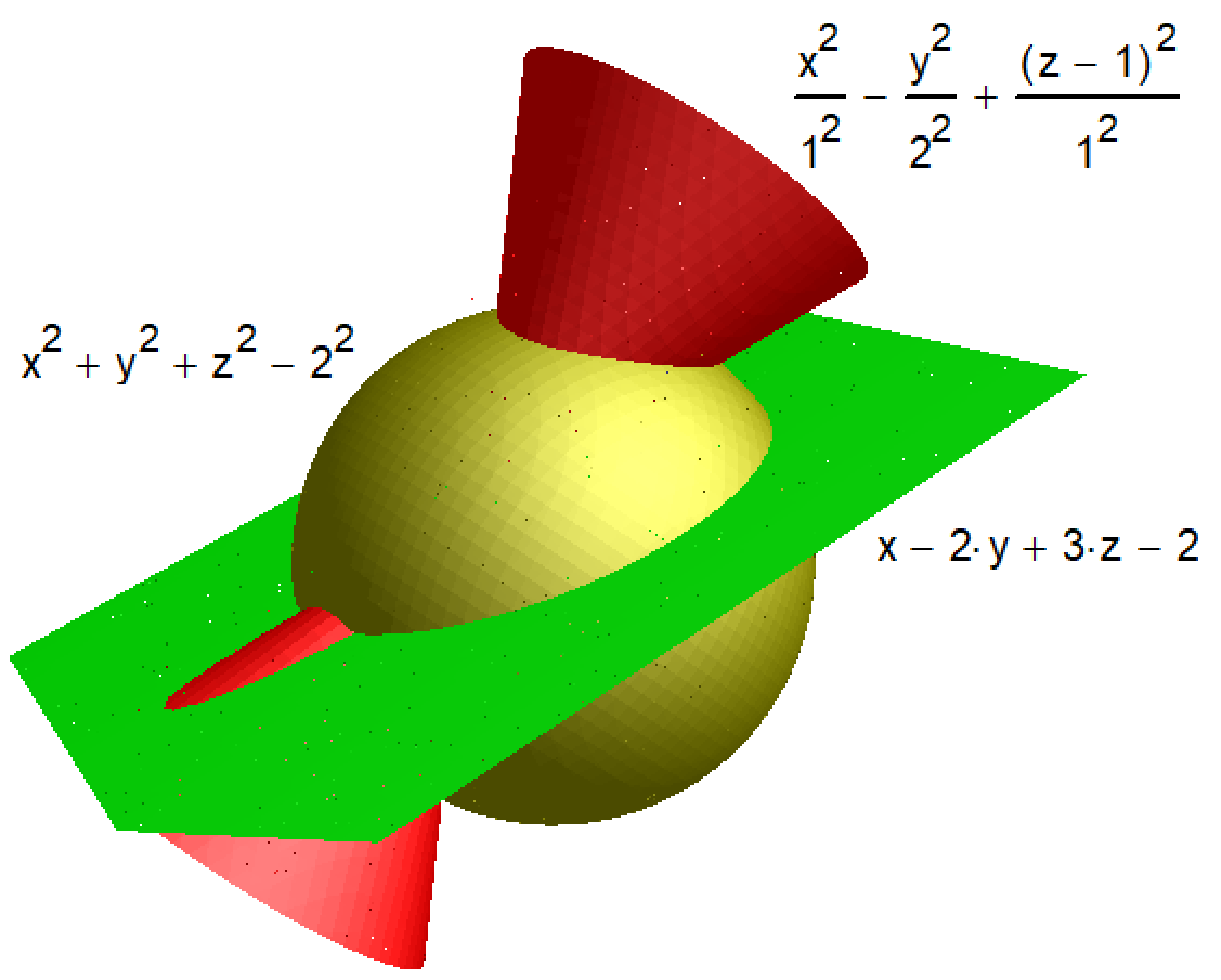

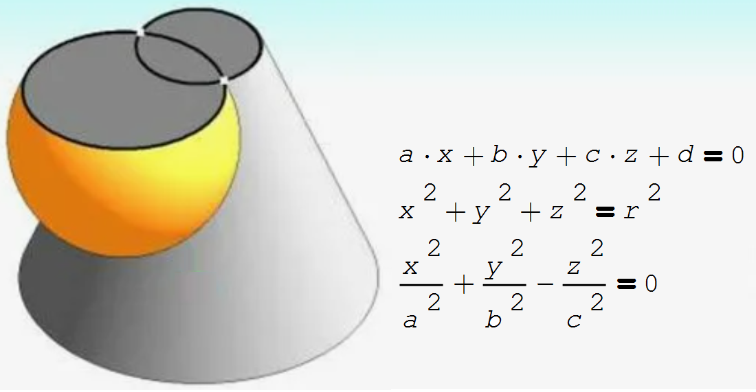

I want to solve three equations with three unknowns and display the solution on a 3D graph with two points - the roots of the equation.
Help please!

Findroot() or roots() could solve three unknown systems.
About plotting, I simply wrote equations according to solving of z.
3Dplot_OchkovVF.sm (4.51 KiB) downloaded 1361 time(s).

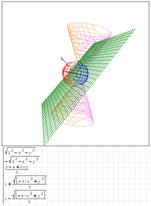

#4 Posted: 2024/2/21 06:54:08
1,355 likes in 2,271 posts.
3Dplot_OchkovVF_Kr.sm (329.75 KiB) downloaded 1451 time(s).

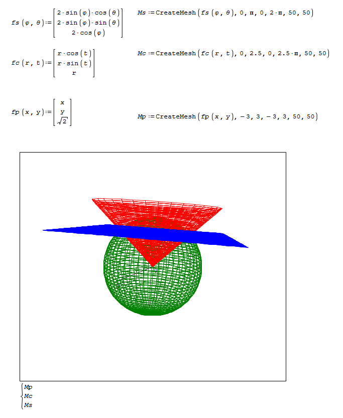

#6 Posted: 2024/2/22 18:38:16
StvMath
StvMath
44 likes and 1 dislikes in 71 posts.
Is there a way to use CreateMesh() for single line xyz equations?
x^2+y^2+z^2-2^2 creates a sphere in 3dplot, a finer mesh can look better.
But I don't know how to convert an equation to CreateMesh().
I am asking if it is doable of course, if they are two different thing it is ok.
A simple, short but inclusive tutorial would be beneficial.
Like in the attached? (Though I confess it was a "suck it and see" approach as I don't fully understand the 3D graphing!)
TriangleSpherePlaneCreateMesh.sm (6.92 KiB) downloaded 1445 time(s).
