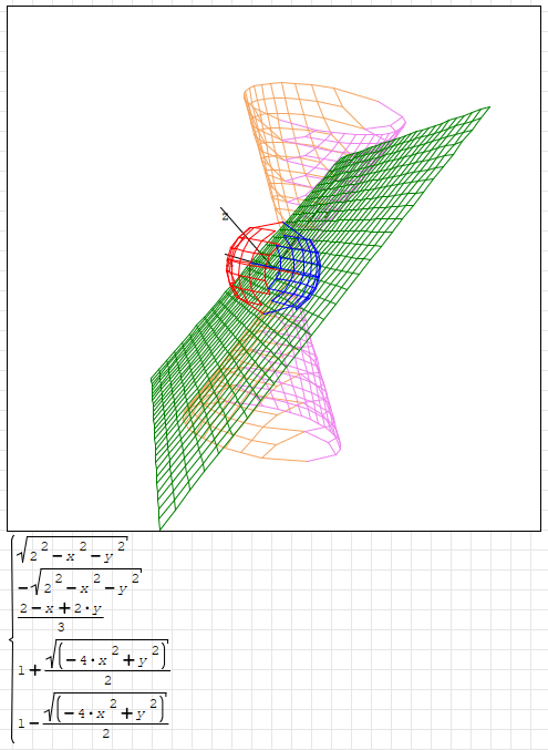

Findroot() or roots() could solve three unknown systems.
About plotting, I simply wrote equations according to solving of z.

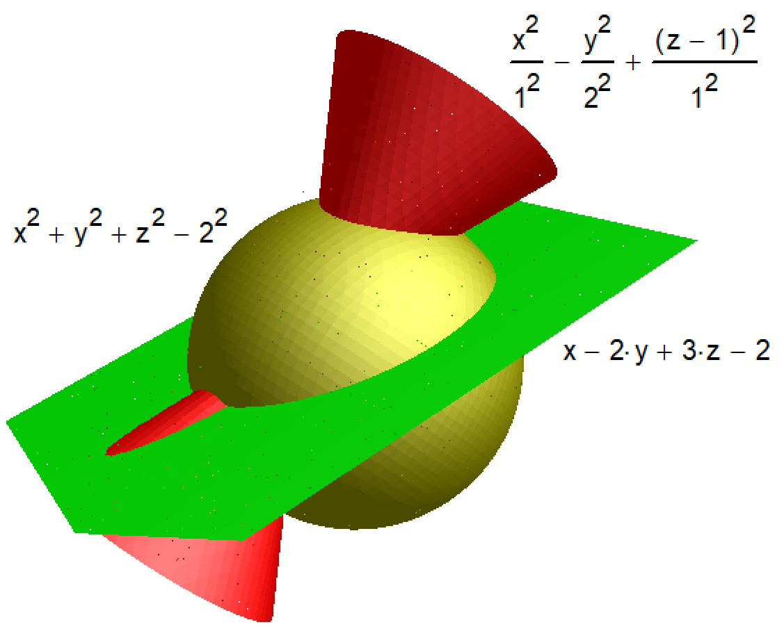

Is there a way to use CreateMesh() for single line xyz equations?
x^2+y^2+z^2-2^2 creates a sphere in 3dplot, a finer mesh can look better.
But I don't know how to convert an equation to CreateMesh().
I am asking if it is doable of course, if they are two different thing it is ok.
A simple, short but inclusive tutorial would be beneficial.

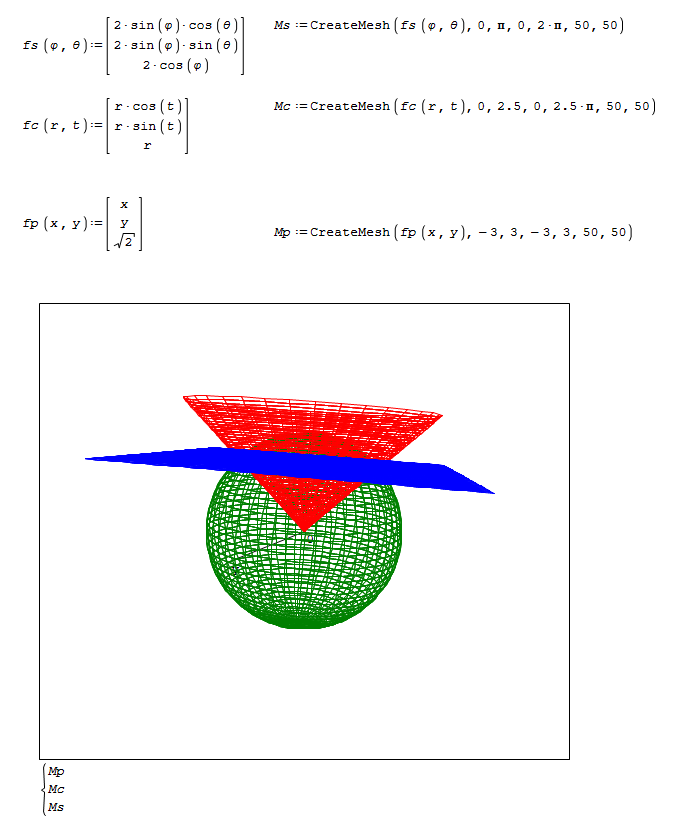

Like in the attached? (Though I confess it was a "suck it and see" approach as I don't fully understand the 3D graphing!)
TriangleSpherePlaneCreateMesh.sm (6,92 КиБ) скачан 1634 раз(а).

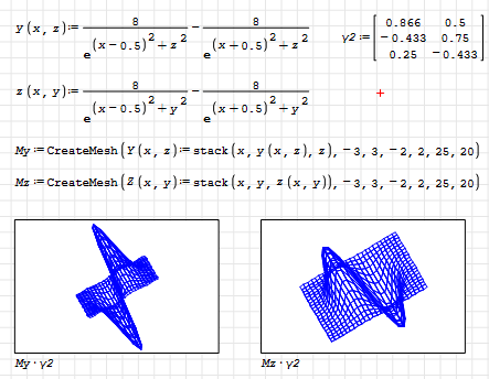

Hi Overlord. If you can isolate some of the x, y or z variables, you can use this. If not, Viacheslav develops a 3D implicit plot codes for mathcad, you can see that somewhere in the mathcad forum.
create_mesh_xy.sm (8,42 КиБ) скачан 1619 раз(а).

WroteI ask for a method converting a xyz function to CreateMesh() matrix.
This is only possible for simple cases if the function is easily parameterizable.
