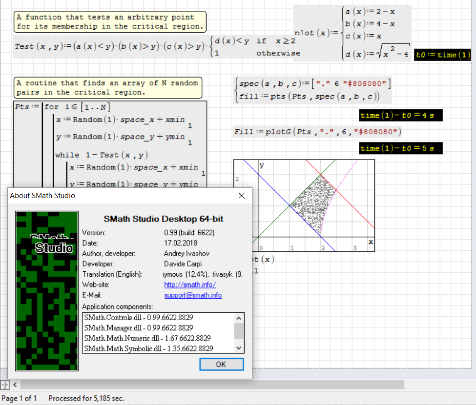

Jean,
It does not work in 6622.
In Graph: (does not display any graph)
Error: Random()= Function is not defined.
Thanks,
Basile

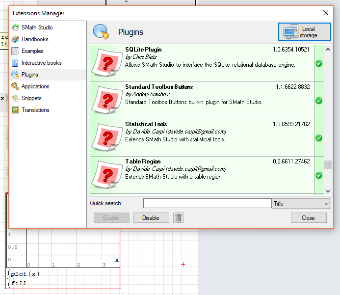

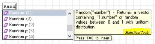

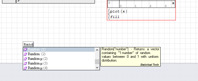

WroteRandom(..) function is from Statistical Tools plug-in. Please check if this plug-in available on your PC.
WroteAm I doing something wrong?
Maybe YES, maybe NO ... maybe an undetected bug wrt your version,
though Andrey said/proved it works. If you visit "Samples", you
will find a huge "Random Utilities" [not more than a month old].
Cheers Basile, Jean
Basile Random.sm (8.17 KiB) downloaded 1100 time(s).

Not sure, but may be this is because of sort order of plug-ins or some additional plug-in which breaks the logic...

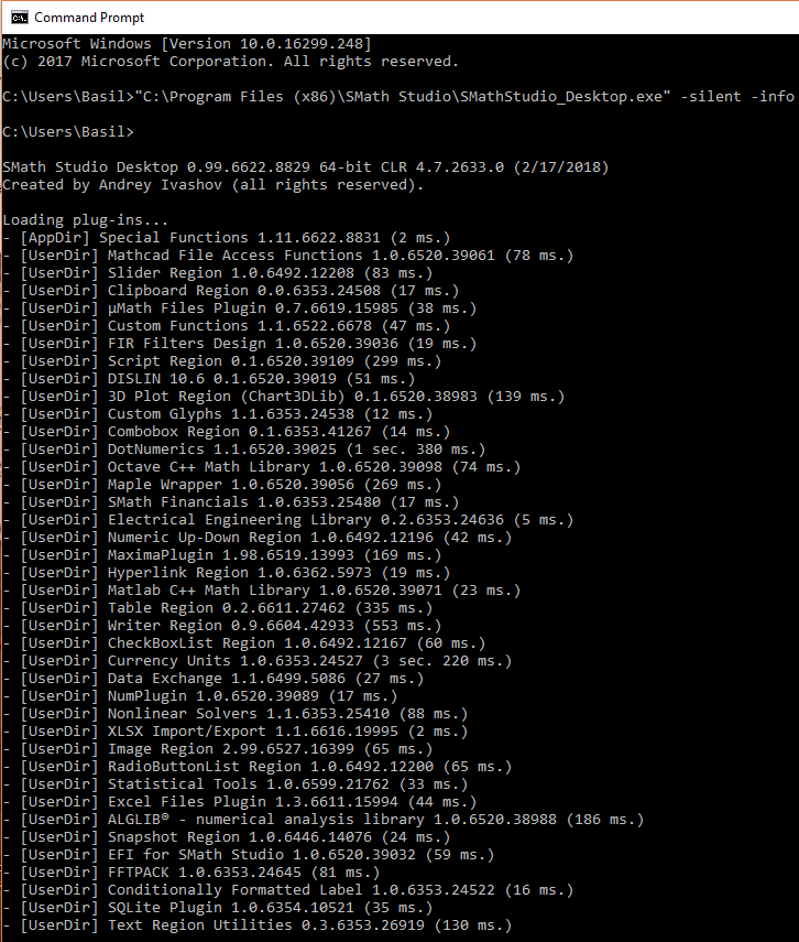

Please could you execute the following in command line? (path to SMathStudio_Desktop.exe may differ on your PC)
I would like to see the output of this command in order to try to reproduce this on my environment.
"C:\Program Files (x86)\SMath Studio\SMathStudio_Desktop.exe" -silent -info
Davide Carpi 2018/2/19 20:37:00
Thank you very much! Now I have everything to try reproducing this issue.
