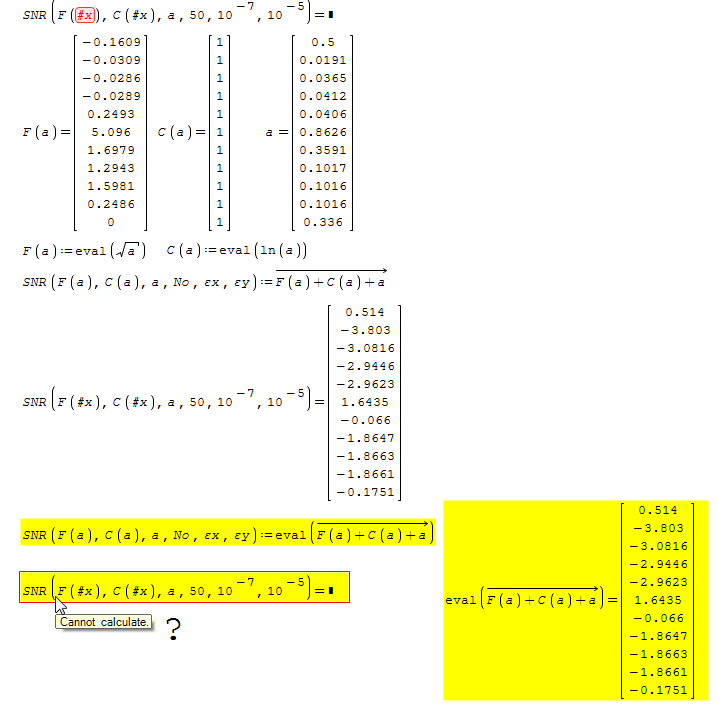

Interesting to know SNRxy(a,N,εx,εy) works fine in your latest SS version.
Two pieces of code SS 6179 does not digest [@ big arrow].
FindRoot works fine manual patience, but could not make work in forloop.
As done, it saturates @ 12 decimals with the two degree of freedom.
I have done my best for myself if any useful for more visitors.
I could see some Matlab code wrt matrices A,B but does explain where
they come from. Still missing some abstract for readers.
Thanks Radovan, Alvaro ... most appreciated.
In short => SS 6179 does not cut the mustard ! a British expression.
Project Solve Flashing Copy.sm (204.07 KiB) downloaded 1496 time(s).

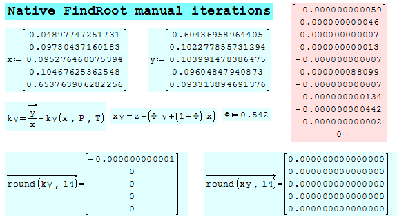

Hi. The troubles that I find solving this is that can't use the normal call for functions, as it is showed at the end, where fails to call the same Newton-Raphson code, but with F(1) and C(1).
This must to be some kind of bug calling functions when the definition of the functions it's complicate or implies the vectorization for the args.
Primer38-undoomed - redoomed.sm (75.78 KiB) downloaded 1451 time(s).

#249 Posted: 2019/2/13 19:25:01
The "redooomed" downloaded but can't open yet. It might suffer same
auto-consumption than FindRoot, i.e: it does not clear itself within a for loop.
It must be called from an external forloop. Will post soon a semi-elegant way
of descending the FindRoot that needs several iterations as it is ± 3 decimals
from the Smath native module. I get 0.0000000000001 as final sanity solutions.
Takes ~ 5 minutes of manual iterations ... Jean is happy !
Cheers Alvaro.
#250 Posted: 2019/2/14 00:44:31
It seems that I am repeating myself periodically.
Like when you start speaking to yourself, indicates the Man is in good growing conditions.
That version is refreshed in 8 manual iterations, easy to use.
Start by the very initials [xo, yo]
Project Solve Flashing Copy.sm (209.05 KiB) downloaded 1449 time(s).

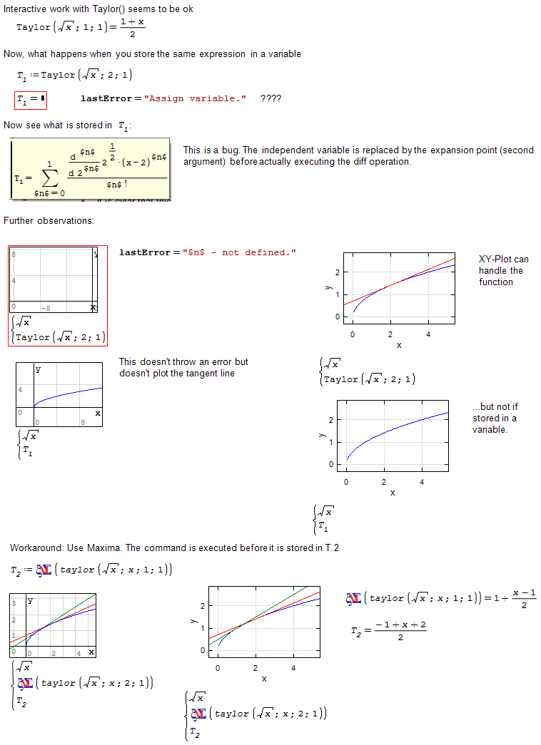

In build 7251, there is a problem with Taylor(), see screenshot. Bugreport filed as SS-4631
Taylor.sm (21.59 KiB) downloaded 1380 time(s).

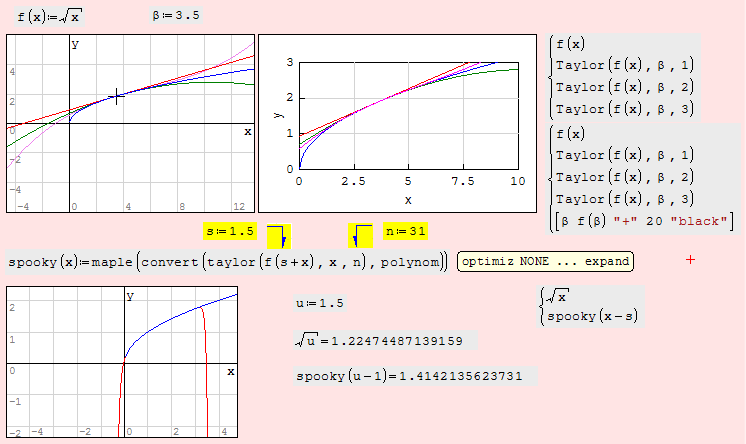

#258 Posted: 2022/9/20 10:18:18
As far as Taylor is concerned, there is no bug in Smath.
Taylor is not a function. Simply a Classroom quick plot demo.
What it plots is not otherwise possible to evaluate.
However, you can play/productive with the spooky Taylor.
Cheers ... Jean ... hope it clarifies.

#260 Posted: 2022/9/21 11:58:53
The missing document.
Maths Taylor Spooky.sm (20.43 KiB) downloaded 1429 time(s).
