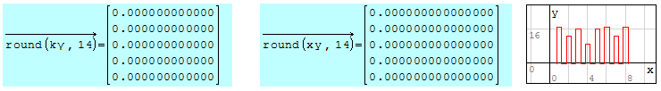

FindRoot works fine manual patience, but could not make work in forloop.
As done, it saturates @ 12 decimals with the two degree of freedom.
I have done my best for myself if any useful for more visitors.

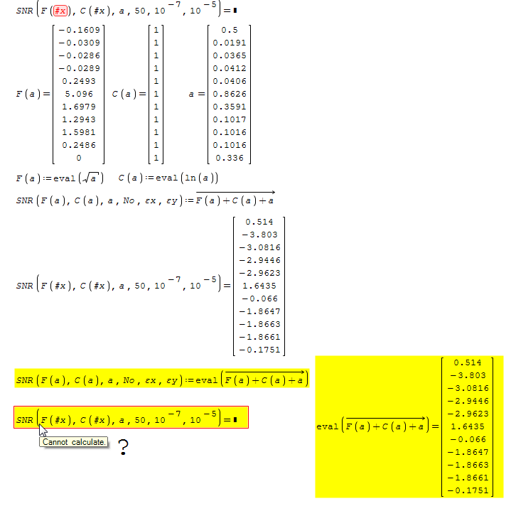

Hi. The troubles that I find solving this is that can't use the normal call for functions, as it is showed at the end, where fails to call the same Newton-Raphson code, but with F(1) and C(1).
This must to be some kind of bug calling functions when the definition of the functions it's complicate or implies the vectorization for the args.
Primer38-undoomed - redoomed.sm (75,78 КиБ) скачан 1669 раз(а).

The "redooomed" downloaded but can't open yet. It might suffer same
auto-consumption than FindRoot, i.e: it does not clear itself within a for loop.
It must be called from an external forloop. Will post soon a semi-elegant way
of descending the FindRoot that needs several iterations as it is ± 3 decimals
from the Smath native module. I get 0.0000000000001 as final sanity solutions.
Takes ~ 5 minutes of manual iterations ... Jean is happy !

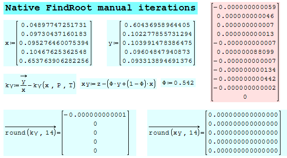

Like when you start speaking to yourself, indicates the Man is in good growing conditions.
That version is refreshed in 8 manual iterations, easy to use.
Start by the very initials [xo, yo]
Project Solve Flashing Copy.sm (209,05 КиБ) скачан 1669 раз(а).

#251 Опубликовано: 14.02.2019 04:49:46
Thank you Alvaro for this. This was a logical thing to do in order to improve your function. Moreover, the "spooky" thing "xx-not defined" appears here and there and I often do not have a clue why. It often appears when you want to use eval(). Someone might have an explanation for this effect you represented in this example, but it still makes me confused and it seems it will remain that way. I suppose you understand now why I called this one as "doomed".

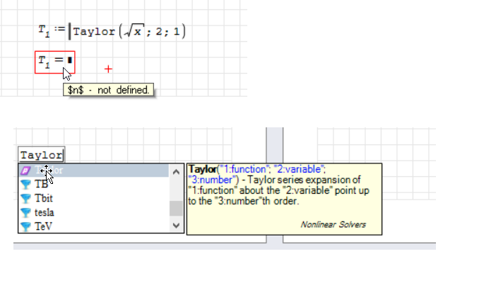

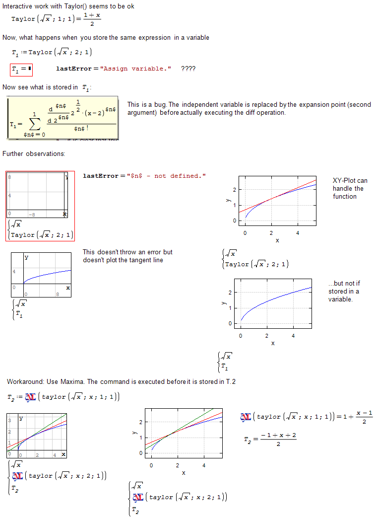

#253 Опубликовано: 29.01.2020 11:59:54
In build 7251, there is a problem with Taylor(), see screenshot. Bugreport filed as SS-4631
Taylor.sm (21,59 КиБ) скачан 1599 раз(а).

you can circumvent the issue using a single-argument line()
I'll check if there is a solid way to fix it, preprocessing in symbolic functions sometimes is hard to handle in many ways....

#257 Опубликовано: 20.09.2022 10:05:29
However, I cannot reproduce the workaround.
Try changing the optimization on the region that shows the error to "symbolic" or "none"
I also thought the 2nd argument was supposed to be 'x', the variable of the function, but you use '2'?
It can be either a number or a variable name (x, x0, z, ...).

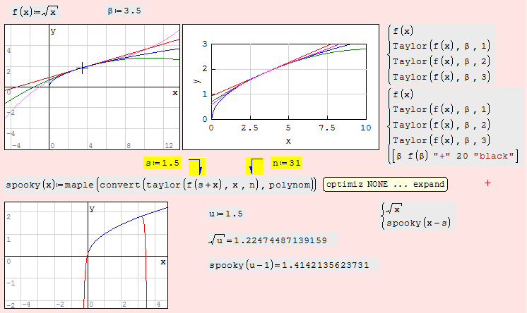

Taylor is not a function. Simply a Classroom quick plot demo.
What it plots is not otherwise possible to evaluate.
However, you can play/productive with the spooky Taylor.
Cheers ... Jean ... hope it clarifies.

#260 Опубликовано: 21.09.2022 11:58:53
The missing document.
Maths Taylor Spooky.sm (20,43 КиБ) скачан 1646 раз(а).
