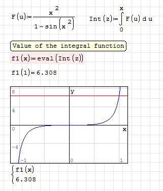

Radovan Omorjan 2016/10/24 17:12:00
Jean,
I just wanted to point out that in spite of "zombies" which return numbers, we are sometimes forced to use root finding, optimization etc.
You also remind me to put some stress to the many examples you posted here regarding different splines including your comments about it. As you pointed out, splines being zombies or not - we often have to integrate, differentiate etc. using splines. I think there were some example of yours worth making plugin functions from them because, as we know, we often can not do that using the current spline functions inside SMath.

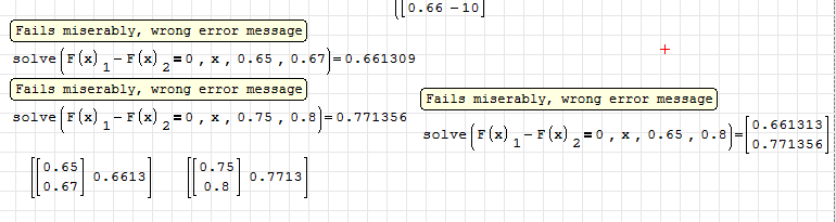

You are right Radovan,
Smath splines [ainterp, cinterp, linterp] are "canvas" plotting
and on-line evaluation. They don't create a function thus can't be
use to integrate directly. You have two alternatives:
1. Dicretise/integrate finites differences
2. Transit via Infinitesimal modules
I went as far as I could in the attached. Plotting the components.
The "solve" block fails miserably, why?
It attempts to retrieve back to the integral that Smath does not
produce. The "solve" does not interpret the integral transit because
the solve block is a foreign entity. The Mathcad find(x) looks incorrect.
It depends upon initialisation. In this case the worng checks right.
Though the Mathcad Given/Find is often robust, it failed 1000's times
in my 15 years Mathacd collab.
Mathcad plots your integral, smath does not, thus it reflects in the "solve".
Please don't hesitate to correct me if I can help more.
Cheers, Jean

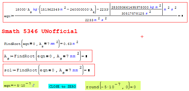

Radovan Omorjan 2016/10/25 10:57:00
Davide,

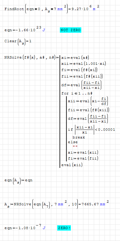

Here is an unforunate example of FindRoot() being unable to solve a problems with units... While my very quick NR Line() solver works just fine.
I wonder if we run into max + number problem or devision by zero.
Hoping for a fix!
FindRootBug.sm (11.93 KiB) downloaded 1407 time(s).
Hoping for a fix!

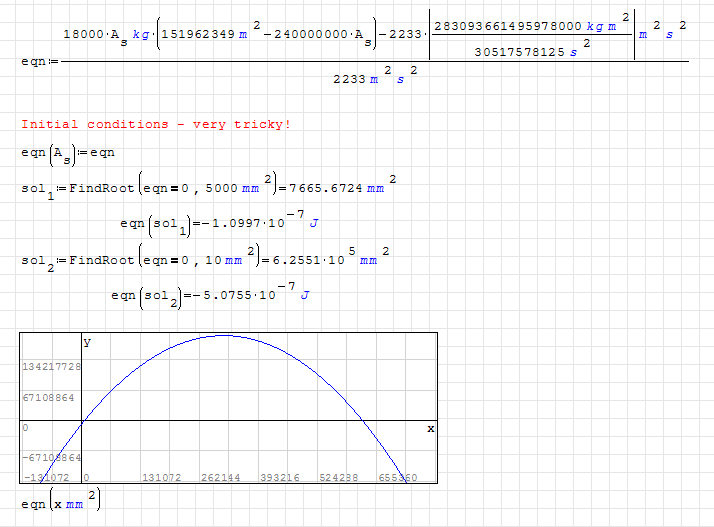

Actually, it could be done - but setting the initial conditions for FindRoot() could be very troublesome for this example.
Initial conditions are chosen just on trial and error, and the calculation can diverge easily by slight changing of IC.
This is basically a second order polynomial having two solutions.
FindRootBug-corr.sm (16.62 KiB) downloaded 1407 time(s).

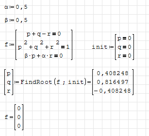

Thanks Davide: I fell in love with SIG !
Yes Radovan: a "Peak/Deep/Root" in the menu would be great,
c/w different options. As robust they will look at the design
stage, they will not be so. Read again "ULP".
Going back to "FindRoot": as it looks in similar applications,
it is same or so Mathcad, a very universal code. For the free
finding solutions, IC must be either 0 or 1 [1 to releive from
"divide by zero"]. In examples [1,2] notice the switch of the
solutions. Be careful as it may scrap the project !
Examples [2, 3], Quaternion and Frobenius are robust and correct.
I didn't completely understand Alex example/problem. A case of
constrained IC difficult to handle and prone to fail.
Cheers, Jean

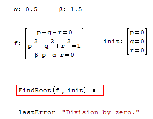

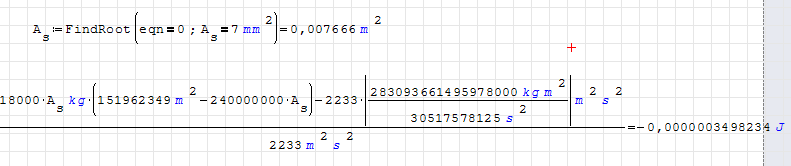

Just for the record (especially for Davide) FindRooot() just does not work in the recent SMath for few of your examples with the error like in the picture. Actaually, it does work when you change the IC from zero to some other values.
Davide Carpi 2016/10/29 12:28:00
That's not a bug Radovan:
=>...For the free finding solutions, IC must be either 0 or 1
[1 to releive from "divide by zero"]<= ... {previous message}
Maybe you are not up to date vs Davide ?
