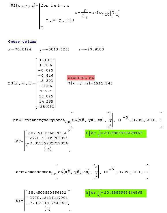

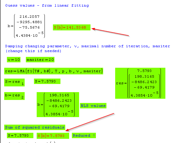

I was playing a bit with optimization .CD functions - of course with my "famous" NLS example. The calculation time decreases on some more acceptable level (order of magnitude - few minutes each) and I could afford more runs for this testing. It seems that for this example the best performance had GausNewton.CD, NewtonMethod.CD and NewtonMethod.CDGSS. Morover, NewtonMethod.CDGSS performed the best (with a bit longer calculation time) - just compare with the result obtained by my LMA() function in the same file. I was expecting much more from LevenbergMarquardt() - to be quite good at this example, but it seems I was wrong. It was quite slow and rather inefficient. Actually, CD functions did some quite good job compared to the original ones. Hope that some more improvements could be done here
The attached are two files (worse and better initial conditions).
The picture is for the worse ones.

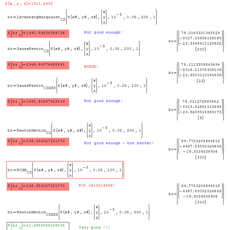

Here is another attempt, with the same problem but now directly minimizing the following standard sum of squared residuals - function S(x,y,z):
[MATH=eng]S(x,y,z):sum(((el(p,i)-10^{x+y/el(T,i)+z*log(el(T,i),10)})^2),i,1,n)[/MATH]
Again, it seems that NewtonMethod.CDGSS() performed the best for this example. Here are two files with better and worse initial conditions. The picture represented solutions with better initial conditions. I tried with different number of points (reduced the variable n in front of the function S(x,y,z) and the situation seems to be similar. NewtonMethod.CDGSS() was the best.
Those functions are promising requiring less computational time and hope that this testing and examples could give you some ideas how to increase the performance of those functions

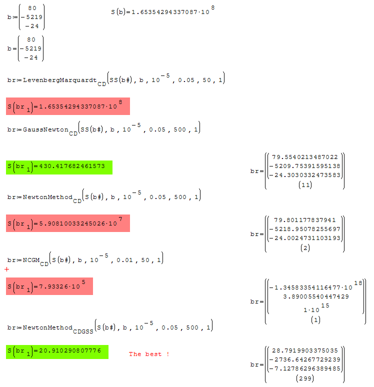

Instead of minimizing sum of squared residuals, I've tried now to use individual residuals in order to minimize them, that will sometimes work (Levenberg Marquard should do the job here). It appeared that it worked well and quite fast for most of the methods . See the attached files *7.sm and *7a.sm (better and worse guess values)
On the other hand, the squared residuals minimization is represented in files *8.sm and *8a.sm. It also worked quite well . Therefore, I am quite satisfied with these CD functions and this example solved in this way. Will see some other example next time.
P.S. It seems that NewtonRaphson.CD() is something wrong. I could not solve my test problem properly, as I was expected based on the previous post regarding numerical Jacobian. On the other hand, in your test file, NewtonRaphson() solved the problem in 7 iteration but NewtonRaphson.CD() solved the same problem in 344 iteration ?
