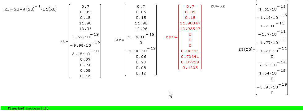

I've seen you're example, unfortunately there are many little "issues" regarding the symbolic engine...
For example observes the first element of your f1(), f2() and f3() (look the attachments);
f1()
SMath seem unable to make a symbolical stack of the function; It's not difficult to understand why... the columns of the results matrix (if all it's correct) are the columns of the last stack argument -> 1; the rows are undefined because if [MATH lang=eng]el(X#,2)[/MATH],[MATH lang=eng]el(X#,4)[/MATH],[MATH lang=eng]el(X#,5)[/MATH] and [MATH lang=eng]el(X#,3)[/MATH] are vectors, the result is a vector... exluding the assumption that all unknown elements are numbers or a "size predeclaring", probably the issue could be solved using a "trial and error" procedure on the unknown size, but I think it's a very hard task
f2()
Here there are SMath issues with derivatives... probably it's the same issue of f3() (and the same of this bug), IMHO all related to the symbolic simplification engine...
f3()
Here there are SMath issues with derivatives and elements...
Since all the issues with derivatives involving the Jacobian, so NewtonRaphson(), HRE.NR() and HRE.RK() in this example can not be used (at the moment, at least)
Here we go again with this @nightmare@ example. If we can not use Jacobian (Smath can'not calculate them from neither of f1(),f2(),f3() functions) - let's try a numerically found one (calculated by my rather simple function Jacnum()). It seems it is working very well with this "driving me crazy" example and using quite bad initial guess and few simple NewtonRaphson with this numerically Jacobian ( Quasi-Quasi-NR-Omorr method )
See the attached example.
By the way, I would suggest you to consider using numerically found Jacobian in Levenberg-Marquardt method as well.

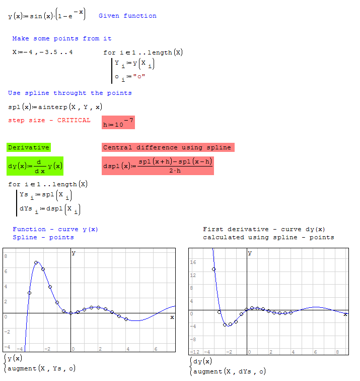

Numerical derivatives, Jacobian, Gradient, Hessian must be sometimes used sooner or later - in spite of their numerical drawbacks.
By the way, I mentioned the following issue few times. You can use cinterp() or ainterp() to obtain a spline interpolation from a tabulated two dimensional data and to find a spline function. But you can not have the derivatives of that function. One of the main reason to use the interpolation methods is to make a continuous function from data which can be then differentiated and integrated - in SMath the derivatives of this spline function can not be obtained at the moment.
P.S. Mathcad is using a variation of Ridder's method for finding derivatives numerically.

This is (again ) my Nonlinear least square test problem. I tried it with LevenberMarquartd(). As might be expected, almost impossible to solve it - large expression and problems with derivatives . I reduced the number of points (n=4) and the LM gave the result. One might try, but it should take more than an hour to get the result. Just wanted to check if this is working. It is working, but that slow and almost useless it this case.
I would kindly ask you just to try, when you have the time, to replace all those derivative dependent things wit some numerical complement. Regarding all those troubles with derivatives, I do not see any other way in order to get out from this very common problem like Nonlinear least squares. I tried to chage your LevenberMarquartd.ref() function and to replace Jacobian() and Gradient() with the numerical ones without success. Gradient() gave me troubles that I could not resolve - Just made it from my Jacnum() function, but it did not work.
Hi omorr,
Seems that the computation efforts are in the Jacobian calculation... BTW I'm implementing Central Differences Gradient/Jacobian/Hessian (in the attachment a test with your primer_47w )

#99 Posted: 2012/10/11 03:20:37
Hello w3b5urf3r,
Thank you very much and I am very grateful to you . .
I'm looking forward to it and really hope that this will improve the situation, although the step size is critical here. When you have the time, could you please consider something like Ridder's method I've mentioned. As I understood, the derivatives are calculated with some larger step and decreased afterwards. Something like described here - Ridder's method.
Jacobian Computation-free Newton’s Method for Systems of Nonlinear Equations: http://jnmas.org/jnmas2-5.pdf
...In the attachment a sm file containing the algorithm above... works, but not as expected
It looks quite simple and promising. Therefore, If I would have it available I'll always give it a try first.
