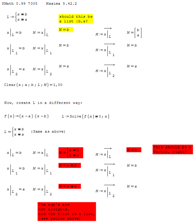

Here comes an image. This may show up differences with smath or maxima versions.
#6 Posted: 2019/3/12 08:51:00
1,355 likes in 2,271 posts.
L is differently defined in the two versions (use the dynamic assistant by mouse hovering over the definitions to see the difference)
in the second case, L isnt't stored in evaluated shape, thus vectorize() doesn't recognise the expression as vector and executes the expression only once.

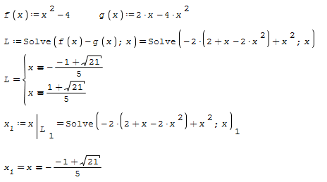

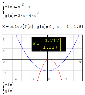

In your example:
it works nice.
If i try the same
it does not. Did i miss an configuration?
#8 Posted: 2019/3/12 10:19:30
... plot first, solve(,,,,) native Smath.
#9 Posted: 2019/3/12 10:35:02
Johannes Piel
Johannes Piel
2 likes in 20 posts.
This is the numerical solution.
My question is about assignin symbolic results.
In the example you see mkraska using L:=Solve(,), and assigning the results.
In my try, you see the result is not assigned as expected,
last line shows
x.1= x=result
but it should be
x.1=result.

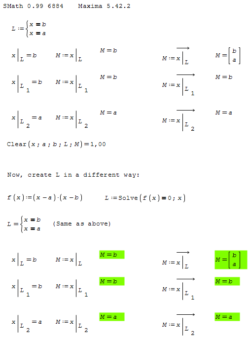

I found the difference between Program Versions.
I tried V0.99.6884 and all works as expected.
L is now assigned identically for both definitions.
The bug may be not located in at().

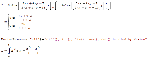

It seems that the evaluation logic in the plug-in interface has changed.
The function Solve() indeed shows a different behaviour (not evaluated/simplified when used in definitions, as if it was behind a line operator)
Other functions like int() don't seem to be affected by the problem.
Blatt39.sm (6.81 KiB) downloaded 1258 time(s).
