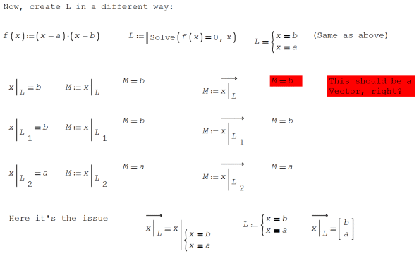

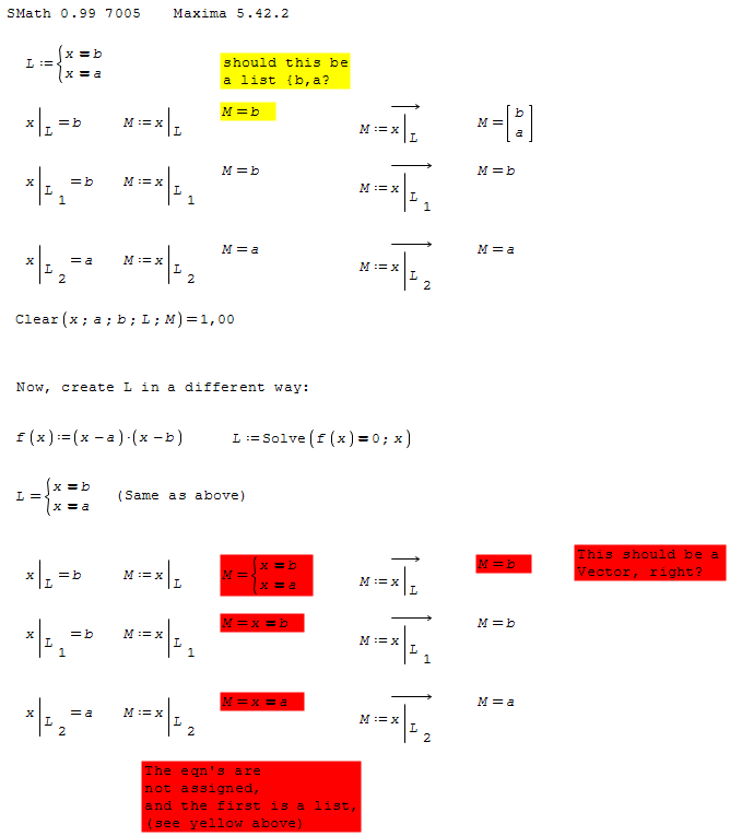

I starting with smath and still try easy examples.
Is found the results of at() to be inconstistent,
but it may be an bad understandig. Could someone review
my appended file?
Many thanks, Johannes
Bug in at.sm (20.62 KiB) downloaded 1355 time(s).

Here comes an image. This may show up differences with smath or maxima versions.
#6 Posted: 3/12/2019 8:51:00 AM
1,361 likes in 2,275 posts.
L is differently defined in the two versions (use the dynamic assistant by mouse hovering over the definitions to see the difference)
in the second case, L isnt't stored in evaluated shape, thus vectorize() doesn't recognise the expression as vector and executes the expression only once.

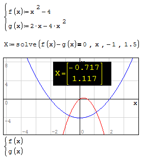

#7 Posted: 3/12/2019 9:24:44 AM
Johannes Piel
Johannes Piel
2 likes in 20 posts.
OK. I see.

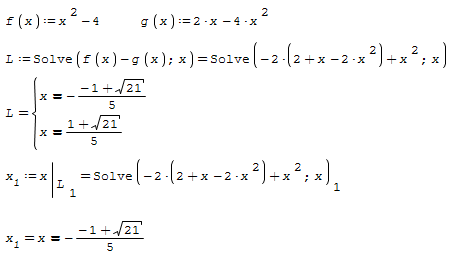

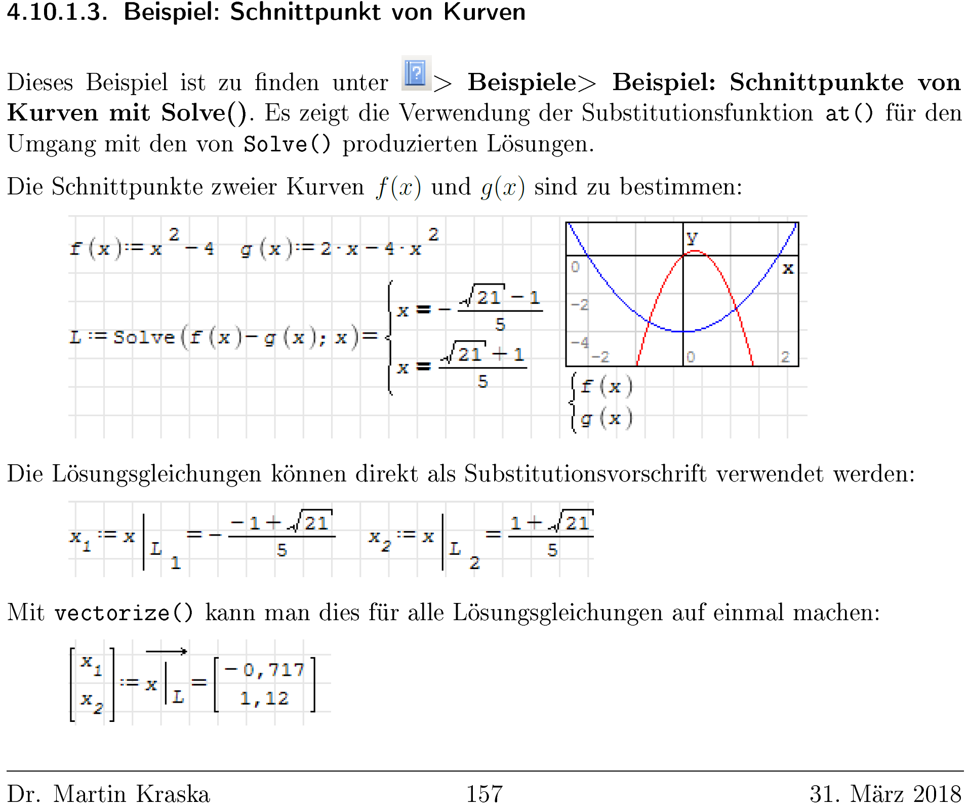

But how can i get L stored in evaluated shape?
In your example:
it works nice.
If i try the same
it does not. Did i miss an configuration?

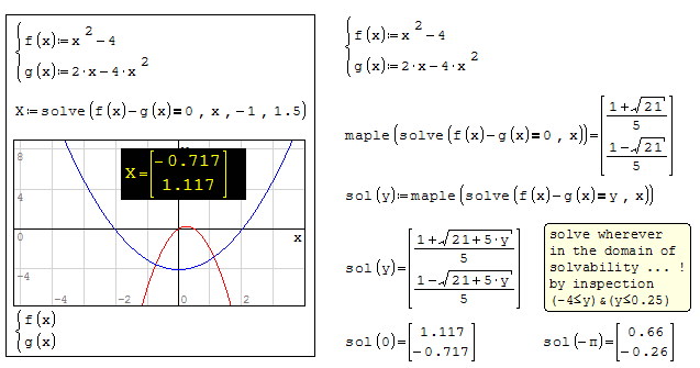

#8 Posted: 3/12/2019 10:19:30 AM
... plot first, solve(,,,,) native Smath.
#9 Posted: 3/12/2019 10:35:02 AM
Johannes Piel
Johannes Piel
This is the numerical solution.
My question is about assignin symbolic results.
In the example you see mkraska using L:=Solve(,), and assigning the results.
In my try, you see the result is not assigned as expected,
last line shows
x.1= x=result
but it should be
x.1=result.

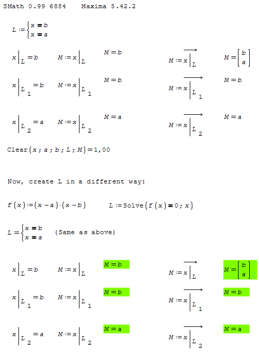

I found the difference between Program Versions.
I tried V0.99.6884 and all works as expected.
L is now assigned identically for both definitions.
The bug may be not located in at().
#11 Posted: 3/12/2019 12:21:16 PM
It seems that the evaluation logic in the plug-in interface has changed.
The function Solve() indeed shows a different behaviour (not evaluated/simplified when used in definitions, as if it was behind a line operator)
Other functions like int() don't seem to be affected by the problem.
