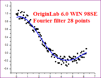

... here is my OriginLab Win 98 SE on XP running Fourier filter.
17 years old, fresh from birth day. Comments about OS to
run fft on Smath: I just don't understand.

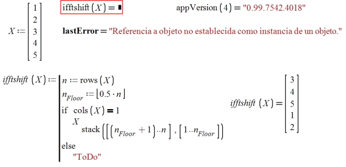

#15 Posted: 2020/9/6 13:40:04
1,443 likes in 2,935 posts.
Thank you Alvaro, I'll fix it ASAP
