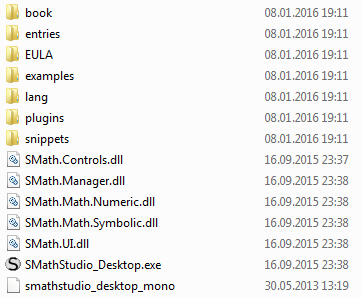

  1. Go in the download page and download the Desktop Linux version of SS
  2. Unpack/unzip the archive in a folder where you want (you can use 7zip or anything else - you have to do it twice, both for the gz and the tar archives)

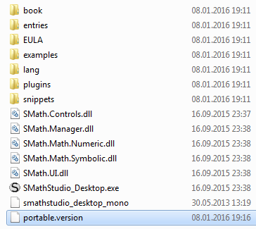

  3. In that folder create a new empty txt file, and call it "portable.version" (you must have the "Hide extensions for known file types" option of your OS disabled);
    you can unzip this to make it simple portable.version.zip (166 Б) скачан 789 раз(а).
  4. That's all, you have a portable* SMath Studio; launch it, open your files, download the extensions made for that version of SS. The installed version or other portable versions does not interact.

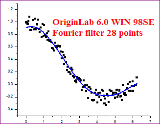

... here is my OriginLab Win 98 SE on XP running Fourier filter.
17 years old, fresh from birth day. Comments about OS to
run fft on Smath: I just don't understand.

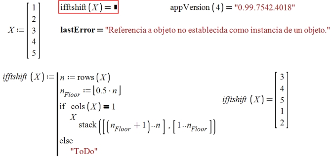

Hi. It's seem that there are a bug here, only for vectors, not for matrices.
#15 Опубликовано: 06.09.2020 13:40:04
Thank you Alvaro, I'll fix it ASAP
Alvaro 06.09.2020 18:43:00
