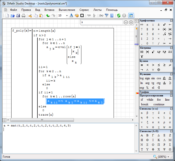

Hi Andrey,
The worksheet in attachment doesn't work in 0.98, but works fine in 0.97.
The error message is "s - not defined". It's bothering me, because of I've used the functions in several documents.
Another issue is that new version 0.98 stays non-responsive for a few minutes when I try to quit SmathStudio.

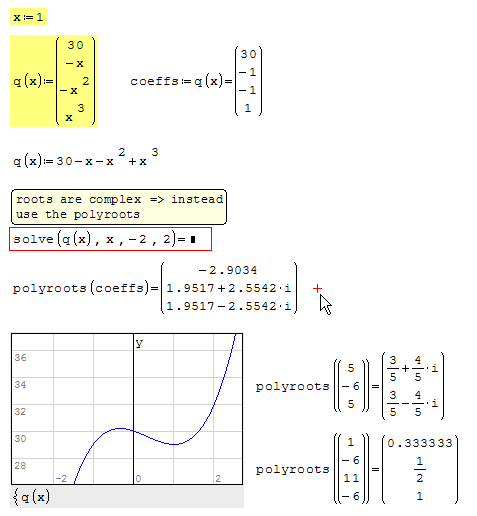

#4 Posted: 2016/3/16 00:55:01
... for the cubic equation, there is in "Samples"
a more robust "Cubic Solver"

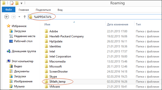

...new version 0.98 stays non-responsive for a few minutes when I try to quit SmathStudio.
I think it is because of some plug-in you have installed on your system. Try to close SMath Studio, then rename SMath folder to SMath_temp in %APPDATA%, then start SMath Studio again and try to close it to see how much time closing will take.

It is because of the following string (in two places):
Starting from SMath Studio 0.98 application handles calculation parts from left to right when no other rules to follow. And it became a rule now which will remain the same in future. So you just need to change places for 1-st and 3-rd operations in your matrix:
Sorry for this, but before 0.98 order of operations in such cases was not actually strictly defined.

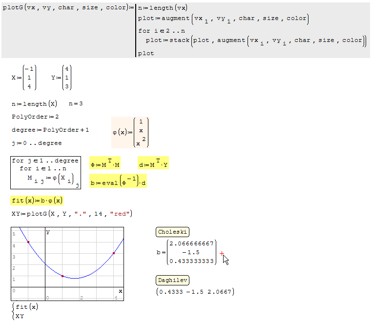

#11 Posted: 2016/3/18 17:09:33
... quick construct
