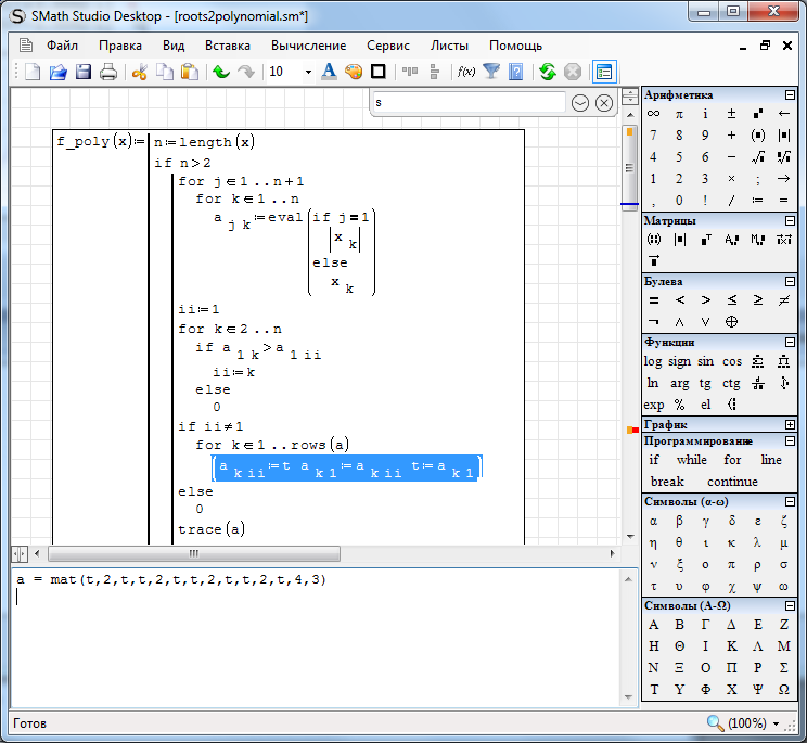

Hi Andrey,
The worksheet in attachment doesn't work in 0.98, but works fine in 0.97.
The error message is "s - not defined". It's bothering me, because of I've used the functions in several documents.

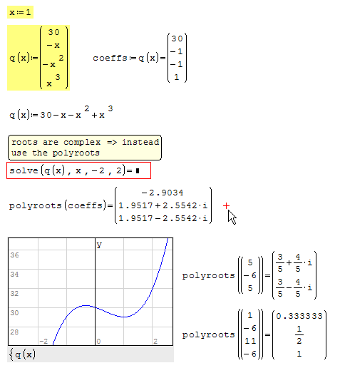

#4 Опубликовано: 16.03.2016 00:55:01
... for the cubic equation, there is in "Samples"
a more robust "Cubic Solver"

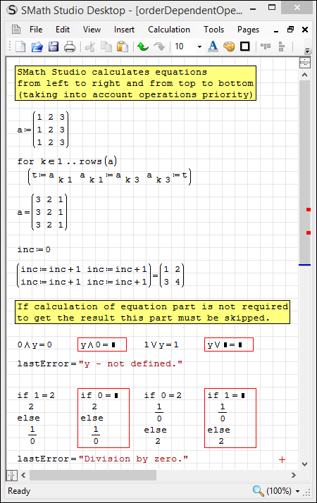

By the way, Andrey, could you please state on the following questions:
1. Currently, boolean operands are always evaluated regardless if it's already possible to deduce final result. E.g.: (x:=1)V(y:=5) will assign both x and y, despite it's enough to only calc left (or right) part to know the boolean result. Could you please confirm or refute that this will always be so (may I rely on this to create simple (not order-dependent) one-liners?).
2. Currently, boolean operands are evaluated from left to right. E.g.: (x:=1)V(eval(y:=x)) will make y to be 1, while (eval(y:=x))V(x:=1) will give an "Undefined" error. Could you please confirm or refute that this will always be so (may I rely on this to create complex (order-dependent) one-liners?).
Thank you for your work!

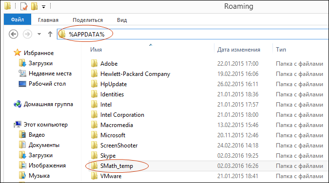

...new version 0.98 stays non-responsive for a few minutes when I try to quit SmathStudio.
I think it is because of some plug-in you have installed on your system. Try to close SMath Studio, then rename SMath folder to SMath_temp in %APPDATA%, then start SMath Studio again and try to close it to see how much time closing will take.
It is because of the following string (in two places):
Starting from SMath Studio 0.98 application handles calculation parts from left to right when no other rules to follow. And it became a rule now which will remain the same in future. So you just need to change places for 1-st and 3-rd operations in your matrix:
Sorry for this, but before 0.98 order of operations in such cases was not actually strictly defined.
You seem to cheat using one-liners that depend on inner order of evaluation. It's not fixed, may change in any new version, so it's unsafe to do that.
Correction: it was unsafe. Now it is absolutely legal way to do such operations. A bit tricky, but legal.
Very good question! For some reason (ah, my stupid head) never thought about it. But later better then never... I just did corrections to boolean AND and OR and the final results you can see on the screenshot:
I think, answer is in the screenshot above.
P.S.: I do realize that these changes may result in errors in some existing calculations, but we need to accept these new rules in order to be sure such issues will never appear again in future + rules of a game are now defined.

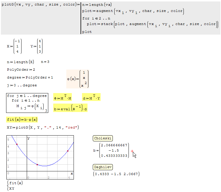

#11 Опубликовано: 18.03.2016 17:09:33
... quick construct
