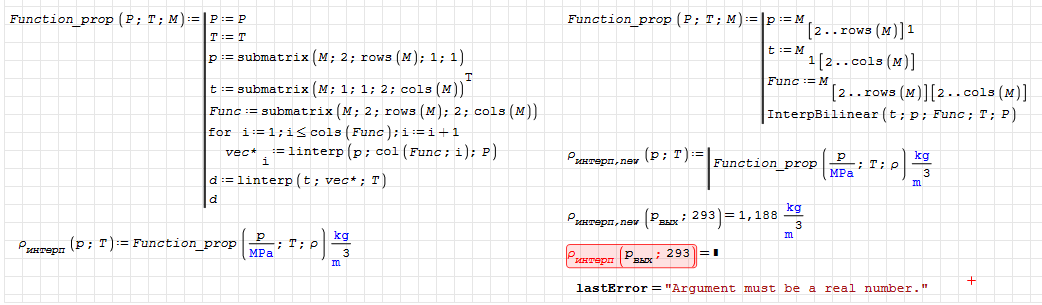

#2 Posted: 2020/3/11 15:01:10
For a long time I can't solve the problem in this program, I can't find the roots
The first error message is in Function_Prop
It says "must be a real number" ?

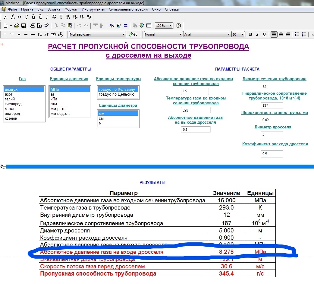

I don't understand you. What should I do? Or, if You can, please correct it
This is the correct response to the variable that should be obtained in the Solve function
InkedRaschet propusknojj sposobnosti truboprovoda s drosselem na vykhode_LI.jpg
I fixed Function_Prop using InterpBilinear() from the Statistical Tools plugin. Note that the definition without line operator behaves buggy, because you even won't get the usual storage preview when hovering over the definition. This is strange and indicates something really bad under the hood.
Yet fixing the function doesn't solve any of the problems downstream. But given the strange error messages and bugs I'd say build 7251 can't be used safely anyways.
BTW, instead the if-else cascades I'd recommend using the selection index as index of a vector of options.

The answer does not match, it might be better if I attach a file from MathCad. I have to translate the program from MathCad to SmathStudio, but sometimes I get errors like this.
Raschet propusknojj sposobnosti truboprovoda s drosselem na vykhode.xmcd (487.33 KiB) downloaded 1089 time(s).
Here is the answer, sorry, that in Russian
