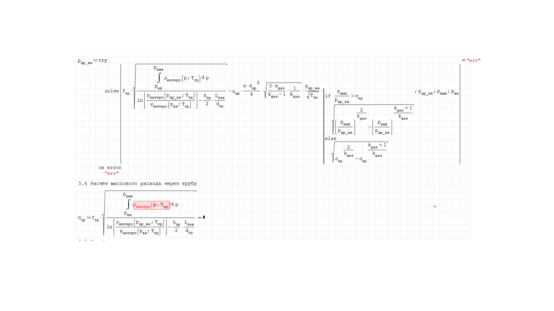

For a long time I can't solve the problem in this program, I can't find the roots

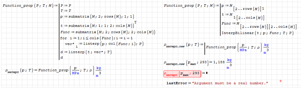

#2 Опубликовано: 11.03.2020 15:01:10
The first error message is in Function_Prop
It says "must be a real number" ?

#7 Опубликовано: 11.03.2020 22:22:58
It`s file without first error, you can use it.
Still red top2bottom
As it looks, you are attempting to integrate kg/m³ over 'p'
for the given 293 °K ... done otherwise finite differences.
In your solve block, vary many things are constants that could
be simplified but so many are undefined.
What should this solve bloc should do wrt the integration ?
find an intersection wrt some 'P' or else ?
The meaning of the cumulative integration reads like this:
"for °K 293, accumulate the kg/m³ over the 'p' range'
In other words: the cumulative mass-flow kg/m³over 'p' range

I don't understand you. What should I do? Or, if You can, please correct it
This is the correct response to the variable that should be obtained in the Solve function

I fixed Function_Prop using InterpBilinear() from the Statistical Tools plugin. Note that the definition without line operator behaves buggy, because you even won't get the usual storage preview when hovering over the definition. This is strange and indicates something really bad under the hood.
Yet fixing the function doesn't solve any of the problems downstream. But given the strange error messages and bugs I'd say build 7251 can't be used safely anyways.

1. Up to this point: NO ... μ.др is undefined
2. If μ.др has a value: plug it in this document.
3. Please, don't re-post your original, so I can do more
from this document.
4. Units don't match in this project.

Define the base viscosity μ.др
The complex term is most puzzling ?

... now that we have the base viscosity, we can plot/tabulate "Bloc".
From there, given some value in "Bloc" we can solve for the pressure
that creates this value .
Cheers ... jean

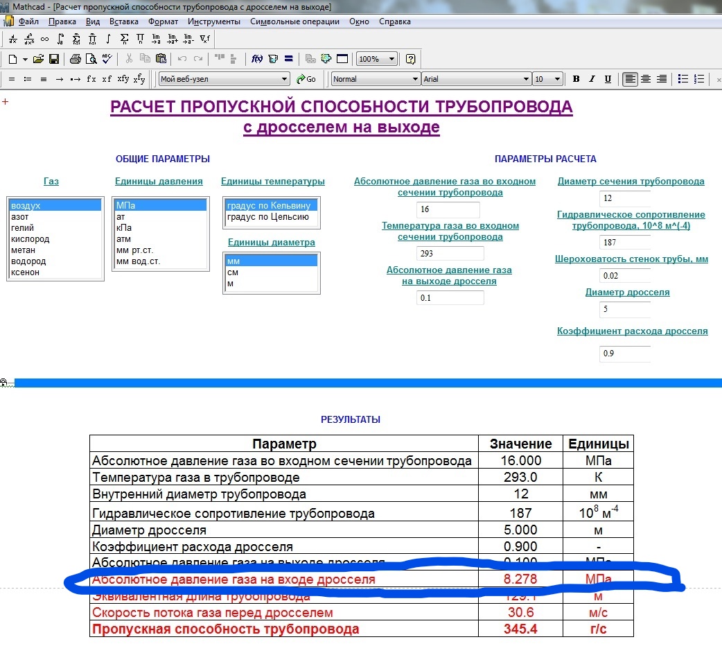

The answer does not match, it might be better if I attach a file from MathCad. I have to translate the program from MathCad to SmathStudio, but sometimes I get errors like this.
Raschet propusknojj sposobnosti truboprovoda s drosselem na vykhode.xmcd (487,33 КиБ) скачан 1291 раз(а).
Here is the answer, sorry, that in Russian
