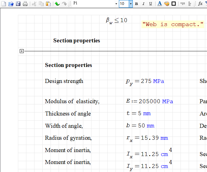

It doesn't seem to be an problem with the P1 font—I've always used it, and it worked perfectly before (my Windows system installed the P1 font). Additionally, when I opened the file today and switched the font to the P1, it functioned normally as well.image.png

0 likes in 6 posts.
P1c_bd.ttf (138.02 KiB) downloaded 177 time(s).P1c.ttf (143.7 KiB) downloaded 154 time(s).
