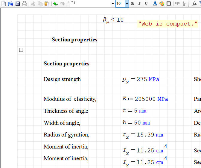

It doesn't seem to be an problem with the P1 font—I've always used it, and it worked perfectly before (my Windows system installed the P1 font). Additionally, when I opened the file today and switched the font to the P1, it functioned normally as well.image.png
#7 Опубликовано: 28.05.2026 04:15:47
Lucky
Lucky
P1c_bd.ttf (138,02 КиБ) скачан 319 раз(а).P1c.ttf (143,7 КиБ) скачан 286 раз(а).
