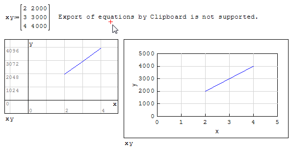

I am plotting arrays of data.
Plots do not fit axes to data, so data are not visible. (win and cloud version)
As far as I can see there only seems to be mouse wheel scaling.
Mouse wheel scaling is not working (v6622 win10) ctrl-scroll scales whole ui, regardless of clicking on graph. (Plot toolbar buttons do nothing)
As data has values in the 20000 range, mouse wheel scrolling out to fit the data is useless.
Obviously also no good to scale x,y same if x=2,3,4 y=2000,3000,4000
Since graph needs to change the fit when the data changes, it must be automatic, again manual mouse wheel scaling is not useful
Example https://en.smath.info/cloud/worksheet/yvgUuxnR
What I see (cloud or studio)

Not sure if you mean that it works for you, or have you done something to get it to scale the axes. Here is what it looks like for me (cloud or studio)
Data is not shown on axes - axes do not autoscale
#11 Posted: 2018/4/3 00:16:40
X_Y plot => you set the x, y limits
the QuickPlot => you wheel/mouse/zoom the x, y
Shift wheel mouse for the x
Ctrl wheel mouse for the y
click in plot shift up/dn, left/right to move the plot.

I have one type of 2D plot inserted by @
I can't see any way to set plot limits.
and no, it doesn't seem to scale by mouse (but it has in the past, however that was not useful as there is such a long way from 8 to 8000, that mouse scaling is just silly.
On my system:
ctrl mouse wheel = zoom whole page
shift mouse wheel = pan l-r
I guess the answer is it doesn't autoscale to fit.

The @ plot is the quick plot. You are correct, it does not autoscale. The X-Y plot that Jean mentioned is a plugin for the PC based software.
I agree, an auto zoom to the correct plot area would be nice
