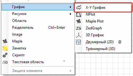

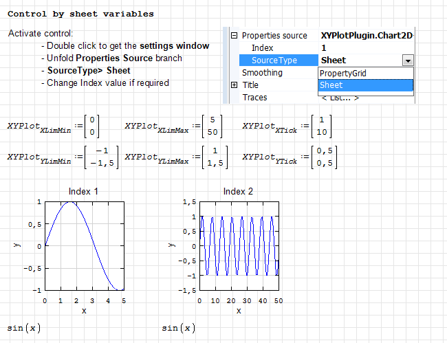

Many users plot functions with an additional plugin named "X-Y Plot" (by user "Uni" )
This plugin offers the possibility to control axis limits (and other stuff) using values or variables coming from previous calculation.
I have moved almost every office calculation tool from plotting with Smath native to "XY Plot" mainly for this feature.
You will find this explained in the XY plugin forum section, or more conveniently in remarkable "interactive handbook" prepared by user MKraska.
Just open the handbook and navigate to Graphics->2D Plot (XY plugin)

1. Size the X_Y plot on your min/max 'x'
2. size Y axis on those min/max ... done.
